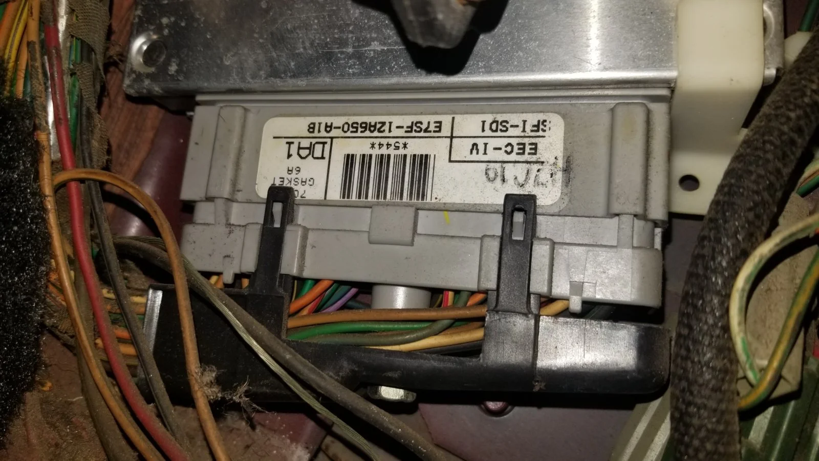

Ive already pulled codes and nothing active. bought this car in Houston. I've had a feeling it was flooded. pulled the ecm connector, cut wire 45 from ecm. Checked voltage and getting 2.71 volts from ecm and another 2.39 volts from map sensor. Guess I got a bad ecm.
So pulled computer and had a label that said for 3.0 Taurus sable only. Is it possible they had it refreshed or can anyone tell by the numbers what kind of computer I have?

Ok mine says da1 so I guess it's the correct computer. Theres a ford sticker on the other side that says 3.0 Taurus sable only along with what looks like a repair sticker from an ecm repair store. If its correct than I guess it's just a bad eec
