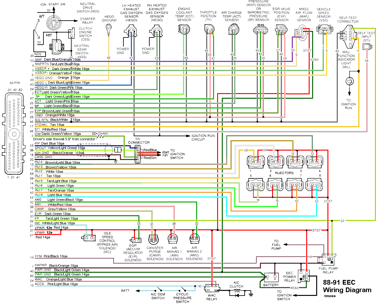

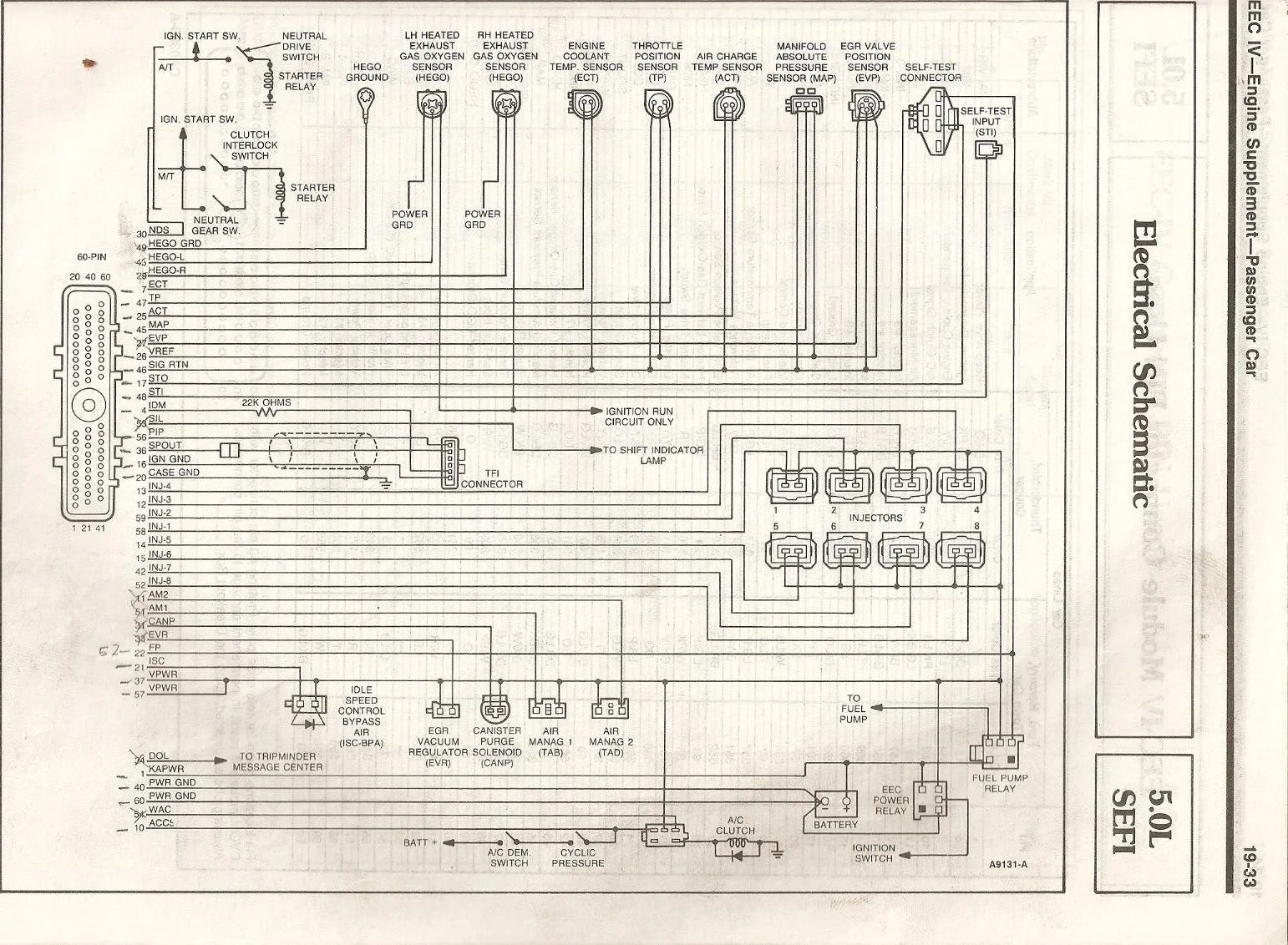

Heres what I would do....Id go to Moates website and buy a QUarterhorse and a Binary Editor license...You have too much stuff disconnected to keep the cera running right especially the EGR as your timing is basically locked out..The 255lph pump will need an adjustable fuel regulator...I use a Kirkey..
Pull the ECU and post the catchcode..If its an A9L youre gonna need it probably rebuilt as the clutch pedal wiring is different and in the 87 grounded to the body...In the A9L the clutch pedal is hooked into pin #46..There are other differences too.

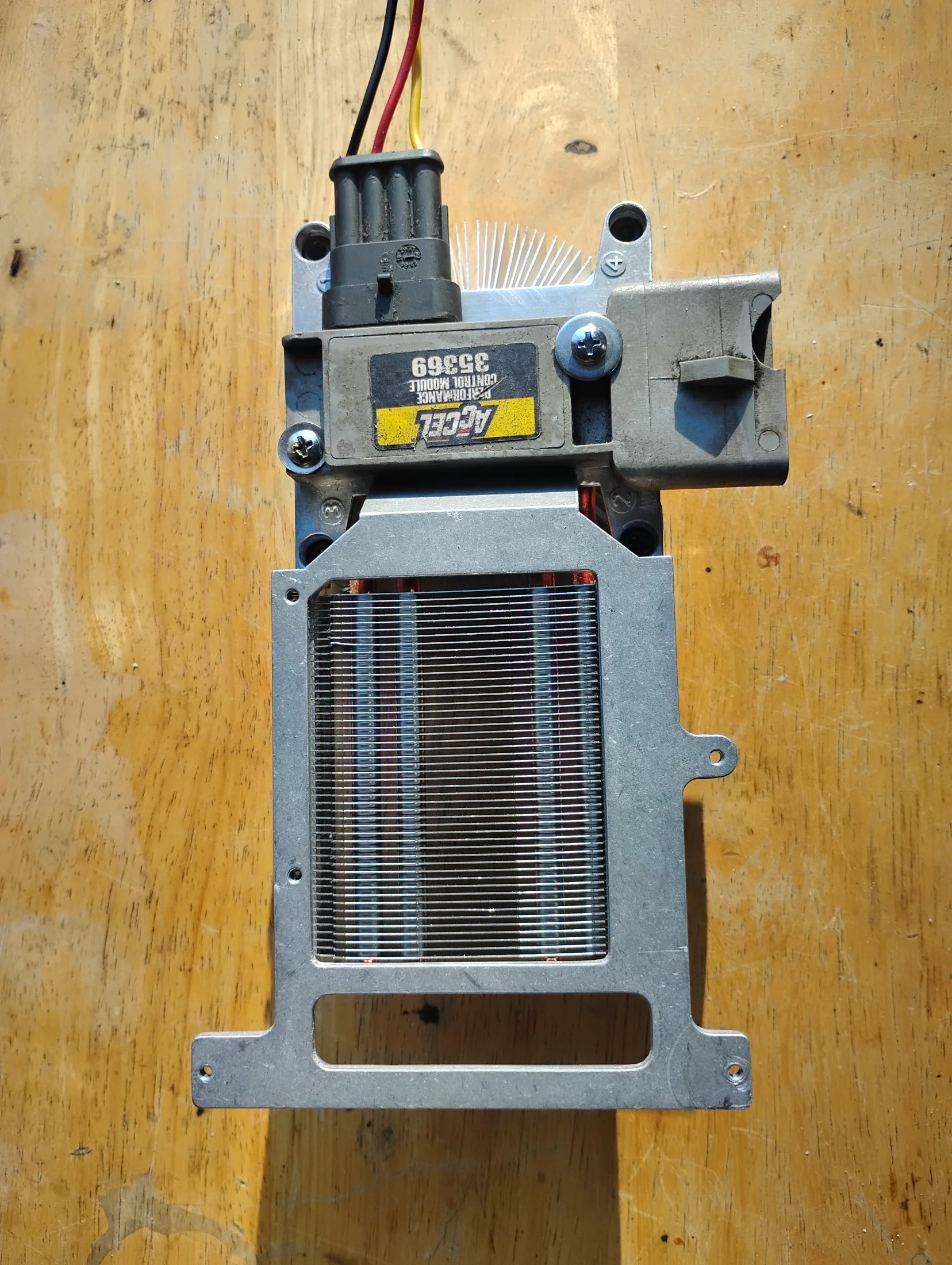

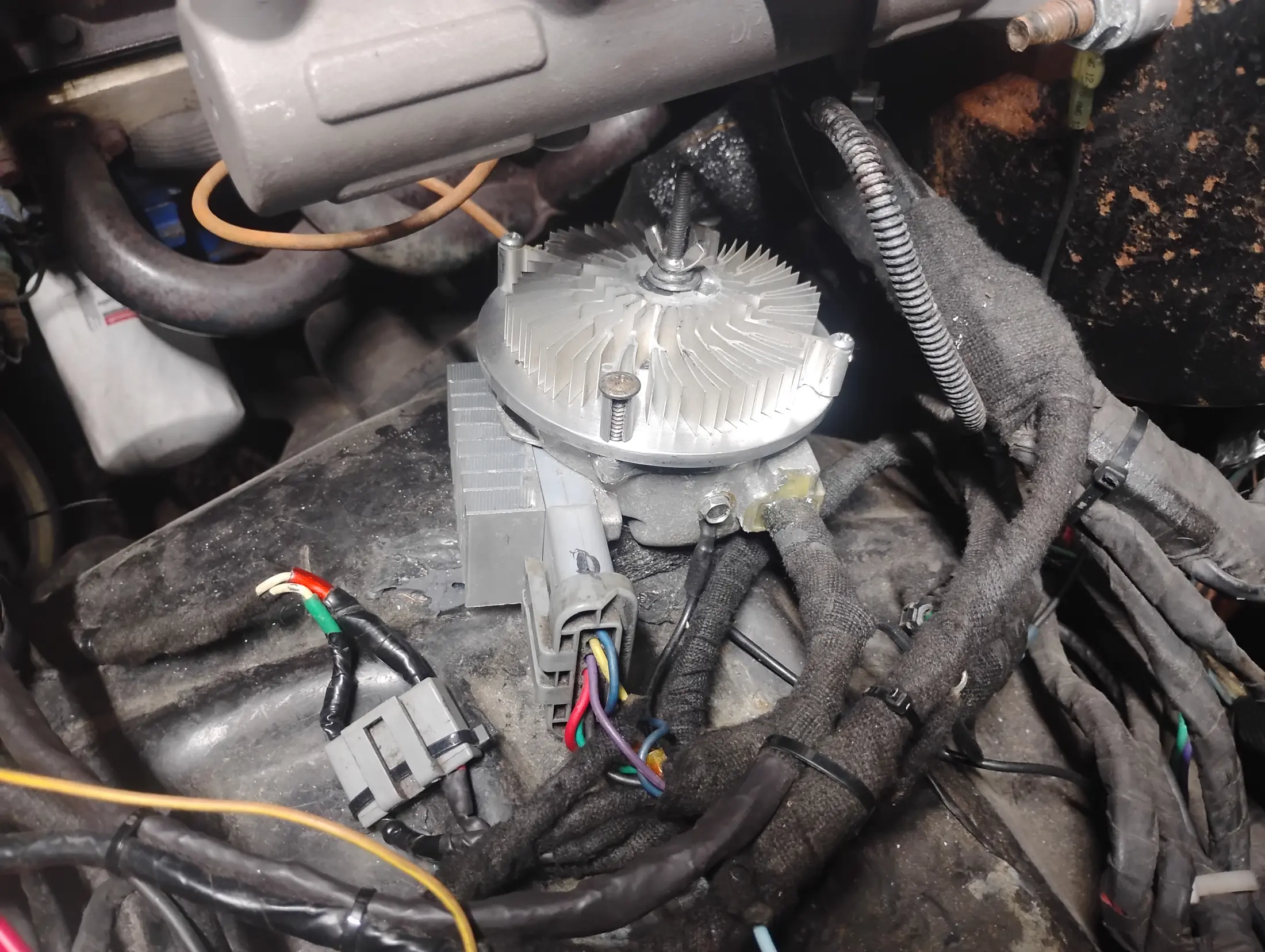

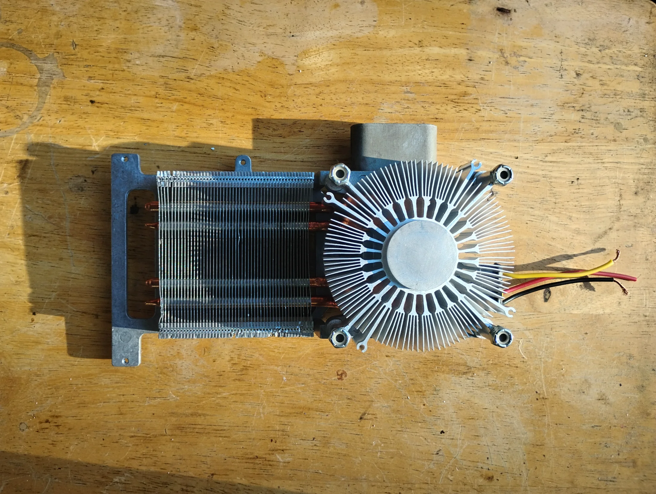

A cheap worthwhile tool to have is a TFI module tester as it tells you the state of the TFI module and it's easy to use a multimeter to test the halls effect pickup sensor....it's the best $12 you'll spend but an even better worthwhile mod is doing the TFI module relocation mod and using the kits on the market either as they create an extra ground loop that causes high interference from rf and emi.
I've been building my own for a while but never considered selling any but won't mind sharing my methodology behind getting a more stabilized ignition system and it's quite complex too ..I plan on posting it maybe today .
