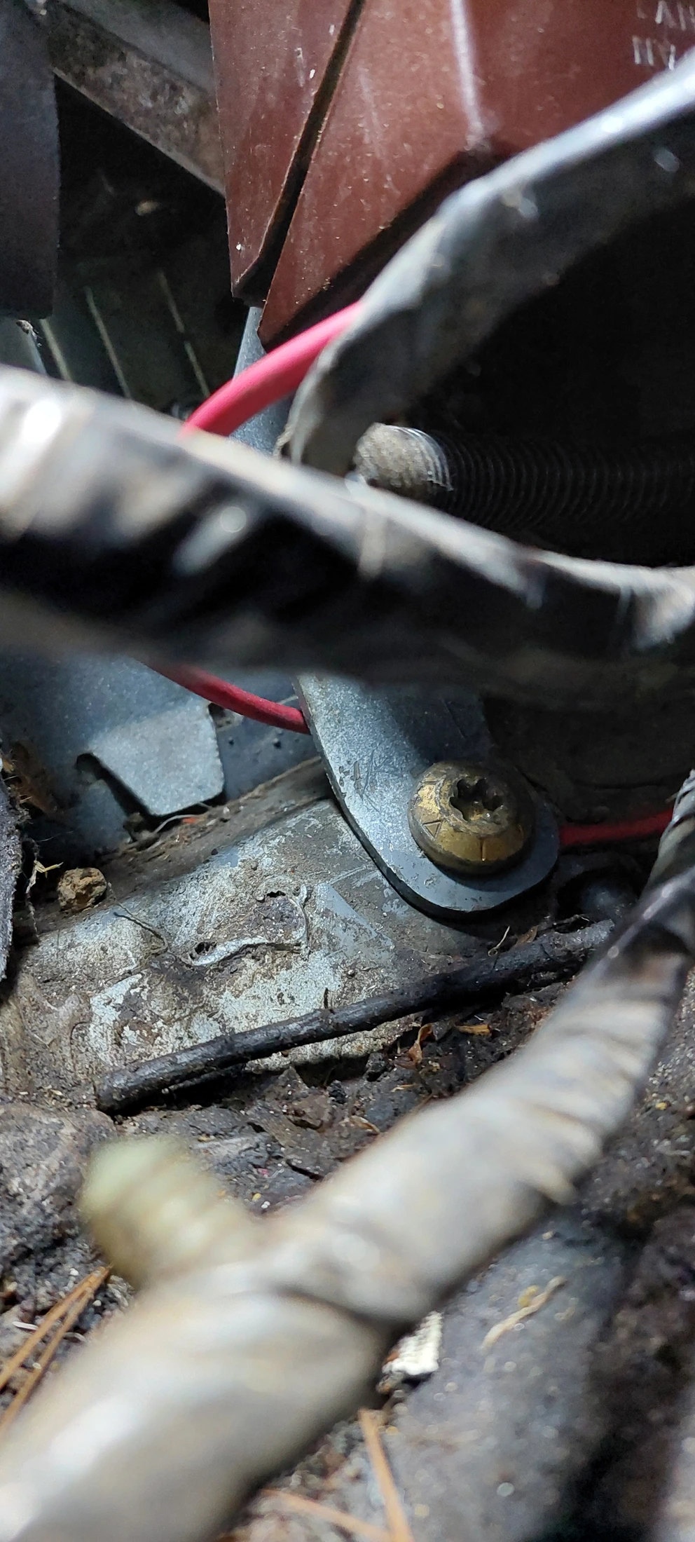

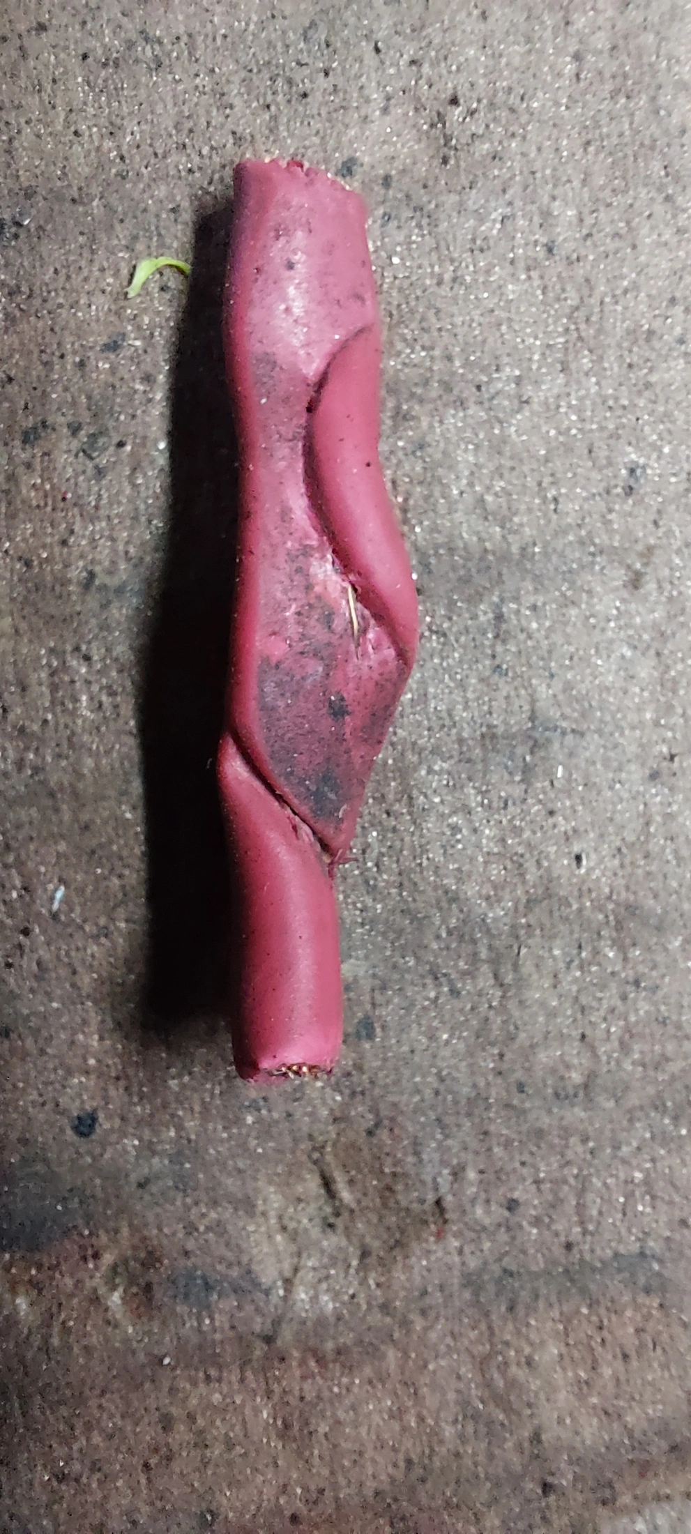

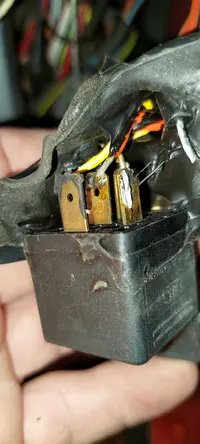

On the driver side I found this red wire that was smashed under the seat belt mount under the rear quarter window. Curious...is this really how the wire was ran to the rear for verts (obviously not under the bracket lol)? (driver side)

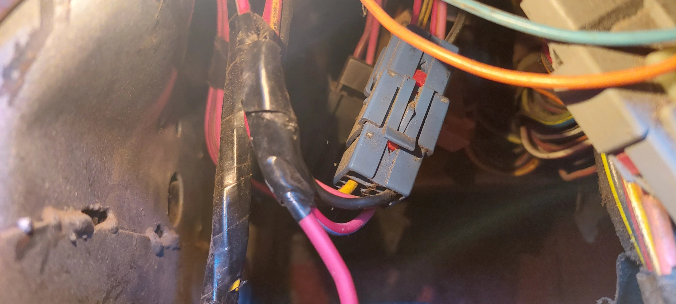

Original Issue: Traced the red (solid) to the driver kick panel. Apparently they simply jumped the red/blue wire (power ignition run) to the rear of the car from the blue connector under the kick panel - they must have thought they had a wire break on the red/blue since the wire simply tapped back into itself under the quarter window.

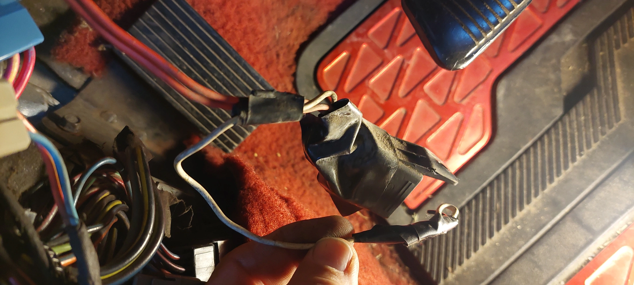

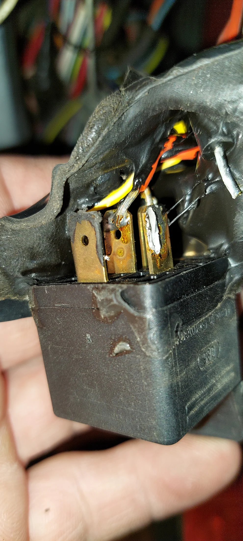

Newly Discovered Issue: Although, I found more mess hoping I can get clarity on. white wire hanging with tape traced to a Bosch relay which connects to the two red wires shown in the image which come from the cloth taped harness-the two red wires look legit, but the relay is a total mess, something isn't right. One red wire goes to two pin black connector (two red/blue wires) at clutch pedal. Greatly appreciate any insight on this if anyone knows. Thanks. EDIT: Does this have something to do with a remote start possibly? Two red wires were not "legit" (factory).
EDIT 2: This was a clutch 12v intercept relay. Prolly/guessing remote start.

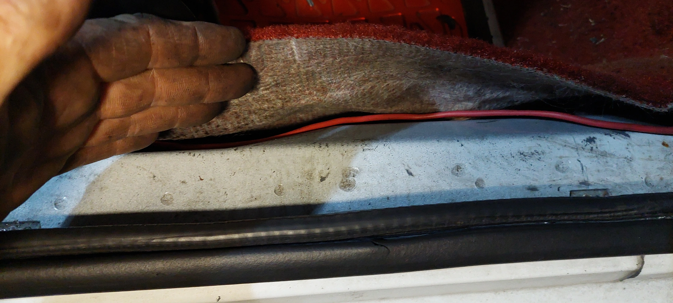

All set on drivers side. Had no idea this thing had rear speakers. :) What will I find on pass. side when I get there.
