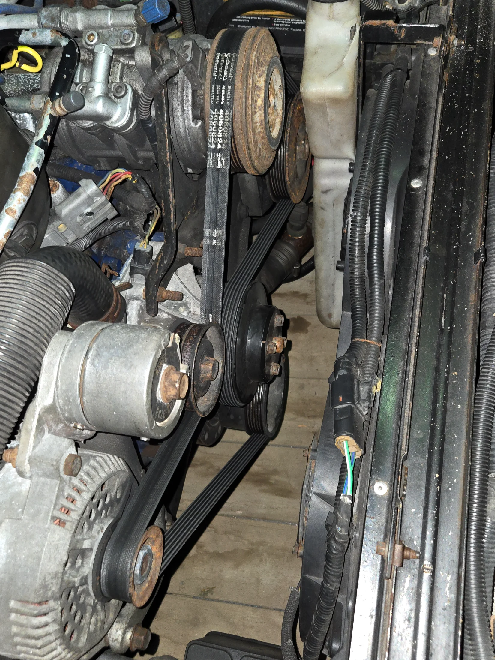

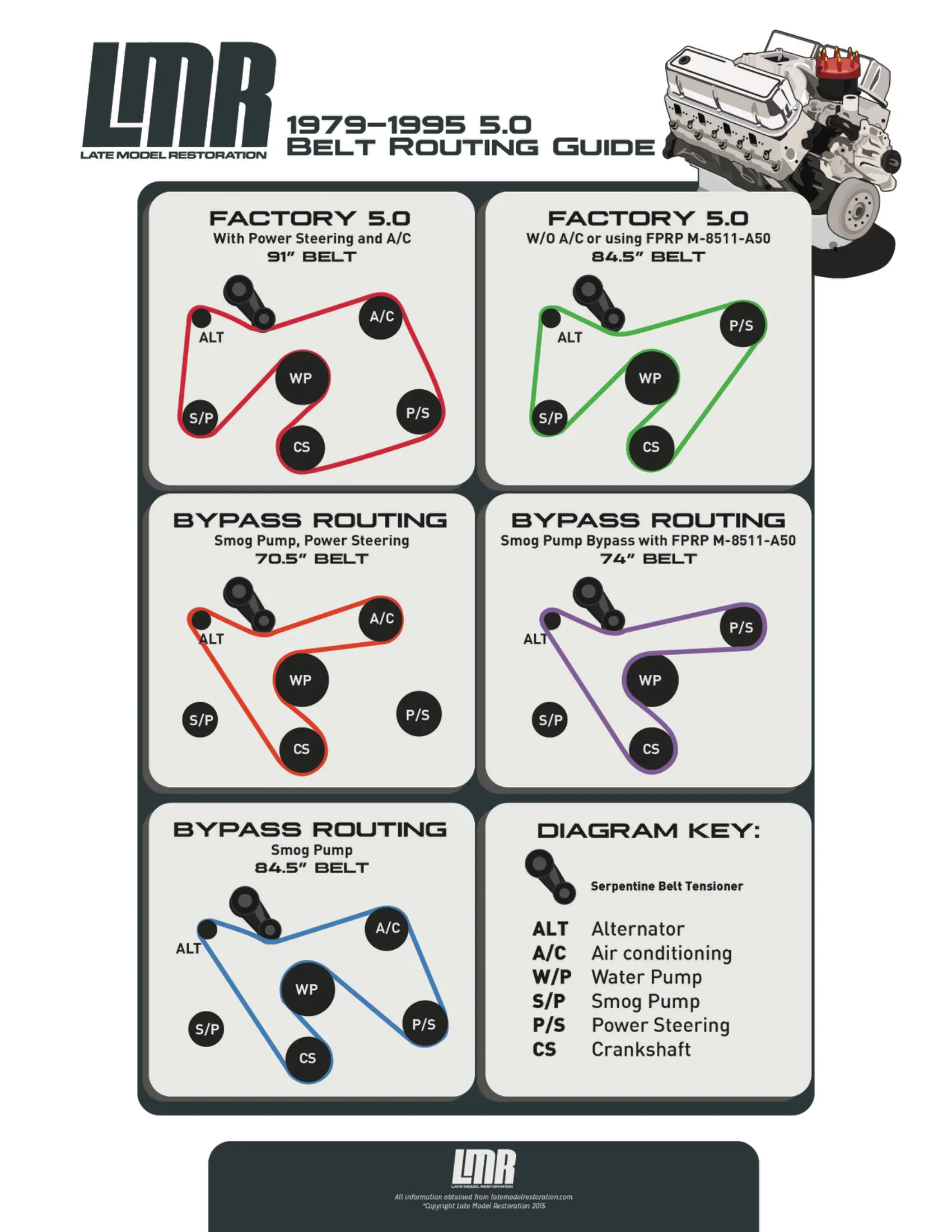

Ok maybe I can’t use search very well on my phone but I need to put a belt on my 89 with just the smog pump delete. I’m not sure what one I need. I have power steering and AC from LMR. If not I can just send 30 belts to my builder lol

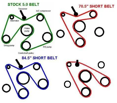

One of these maybe :shrug:

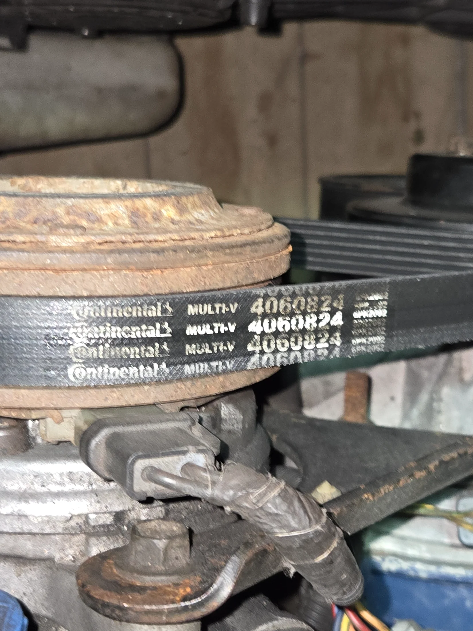

Old diagram I saved years ago. I know my belt is shorter - I want to say 82 or 82.5" off the top of my head, but I have some underdrive pulleys on. I will try and check if there is a part number on it still.

Belt length highly depends on what pullies are on the vehicle. The blue 84.5" routing will work provided the OP has stock pullies. The alternator is the pulley to pay attention to, as quite often folks will do the 3G conversion and leave the bigger SN95 pulley on. If this is the case the 84.5" belt will be a tad bit too short.
