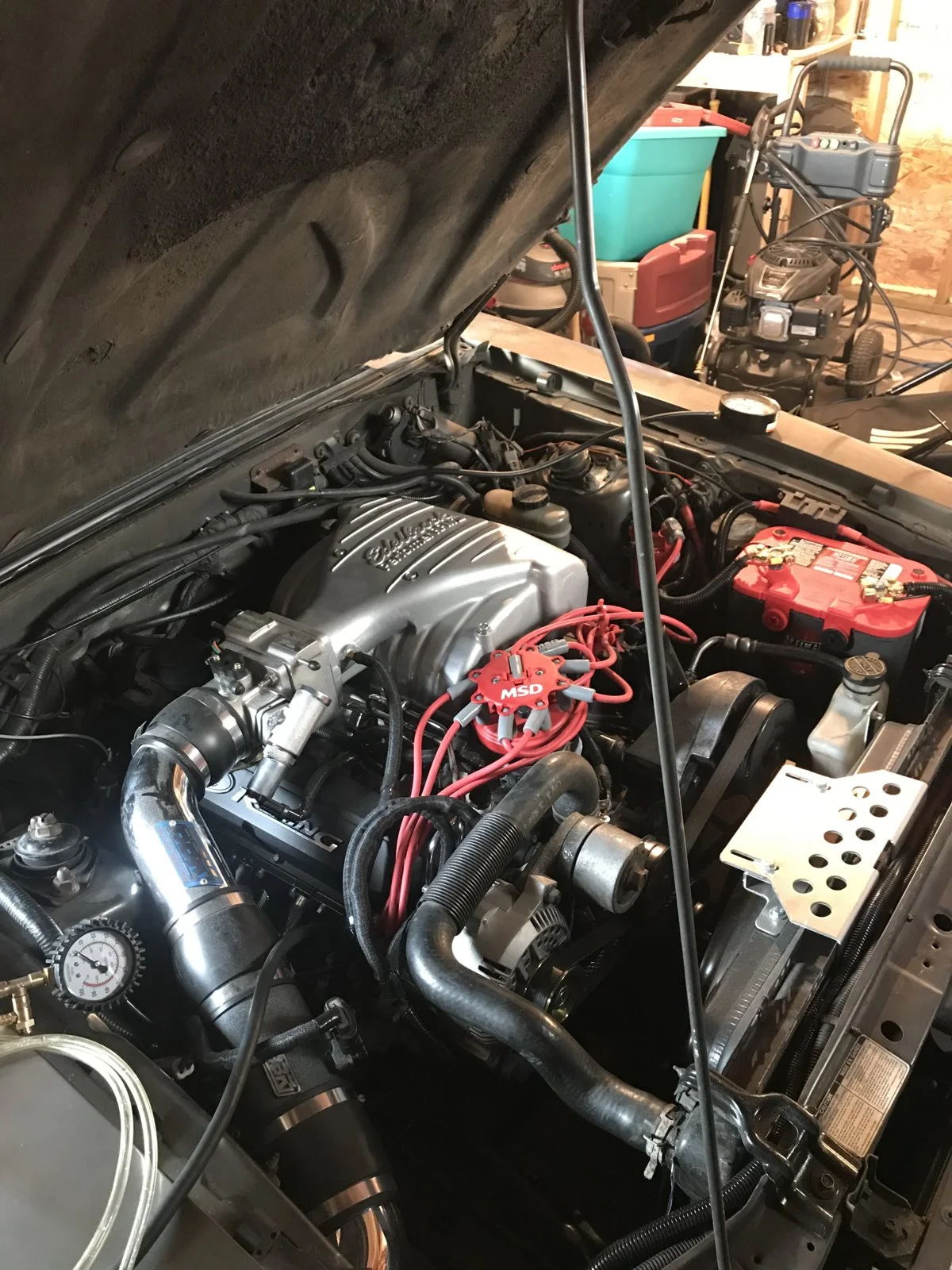

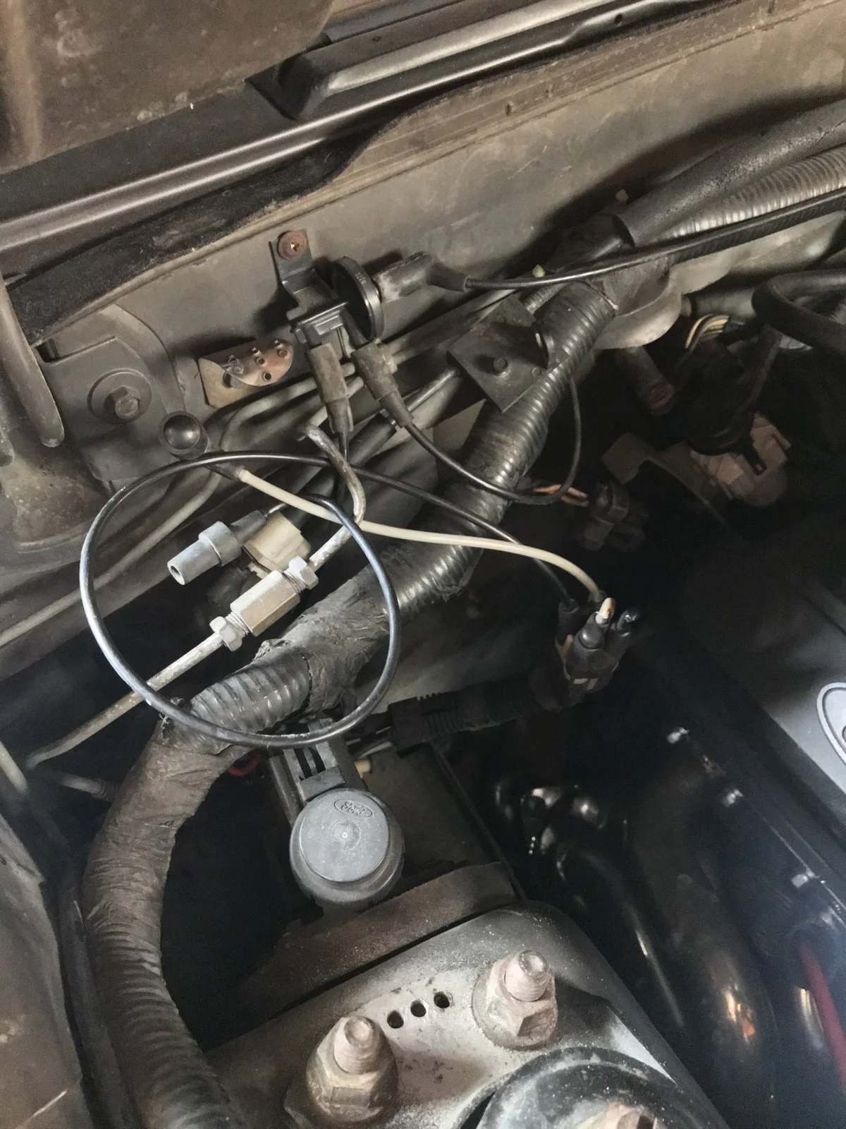

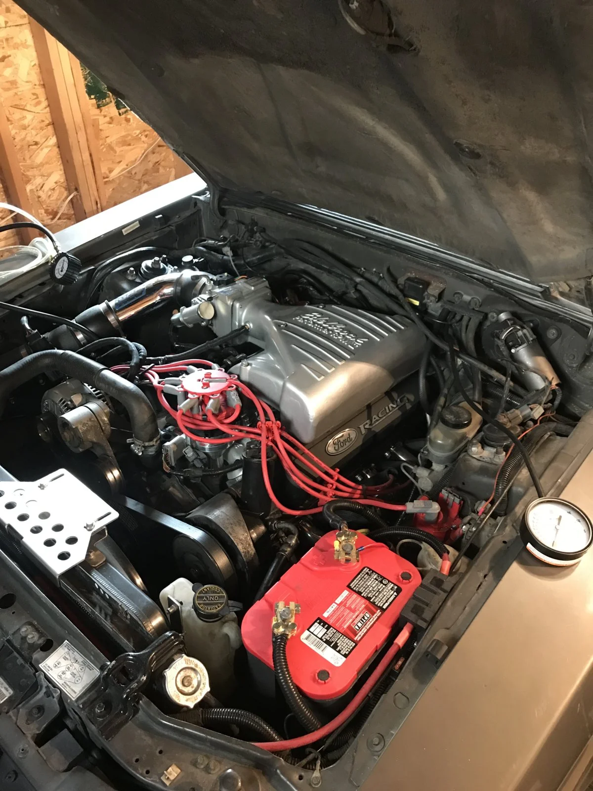

Here are some pictures of the engine
- Is it okay to check vacuum pressure from the originally capped off port on the vacuum tree? (B/R)
- - getting a consistent 8 on the test gauge
- Fuel gauge is plugged into the Schrader Valve
- - fuel comes out when you depress the pin or while screwing on the test gauge fitting
- that melted vacumm block - thingy magiggy
- - I deleted smog and EGR (drive maybe 300 miles a year)
- - - I have the SVE EGR delete kit from LMR
- - - -two are capped 2 are melted closed (Hoses touched the header)

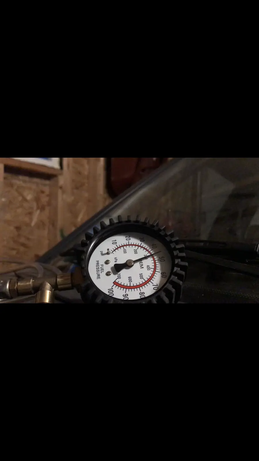

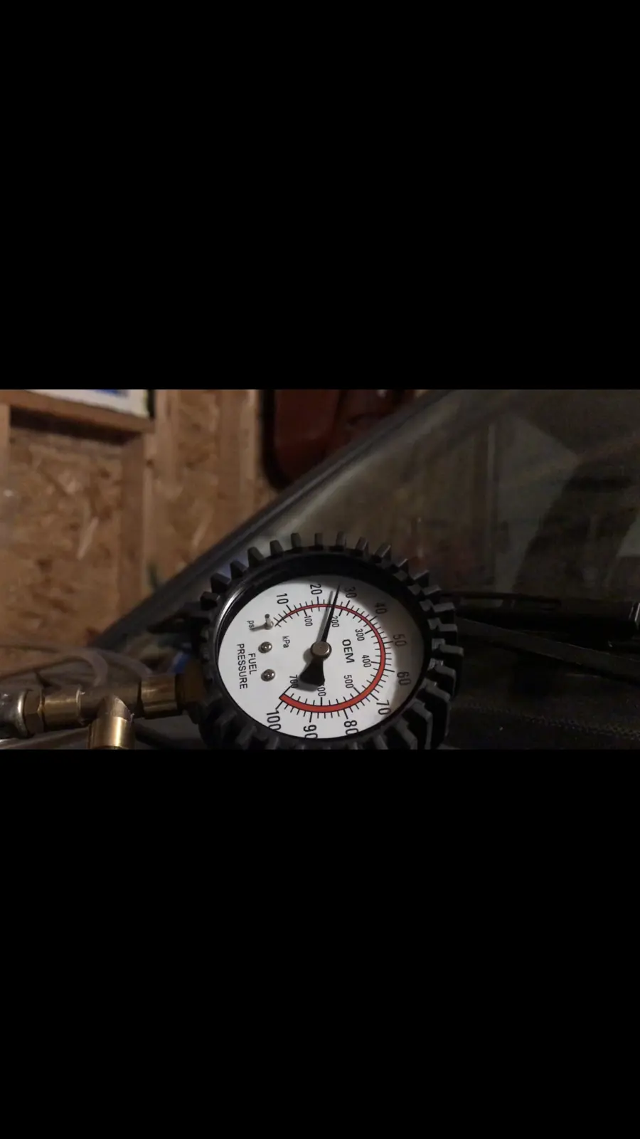

When I turn the key on.. the pressure goes up to 10.. so I adjusted the fuel pressure regulator and I get like 45ish then drops to 25/26. Trying to do my adjustments but if I get it down to 38-39 when first turn key on it will hit that 38-39 but then drop to 25.
Should it be a constant 38-39 with just Key on?
Key on. Pump on - 45 ish
Pump stops priming drops to like 25/26
This was the first adjustment. So lowered it where it will hit 38-39 key on then drop to 25/26 when pump stops priming
