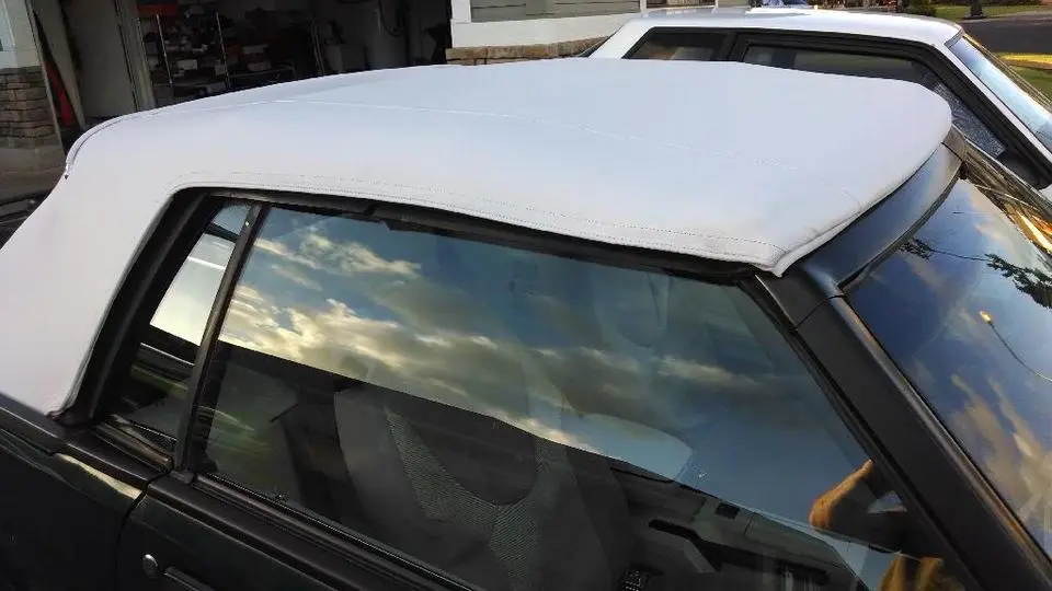

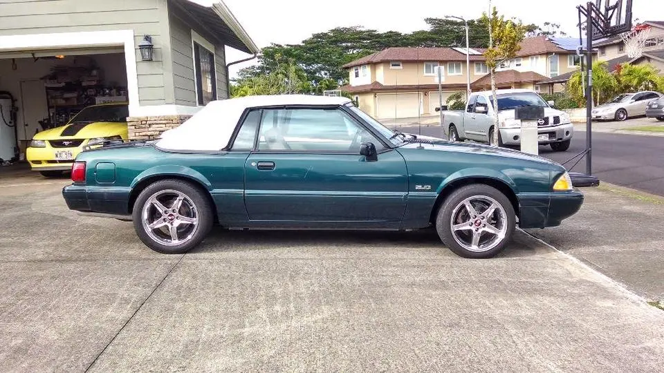

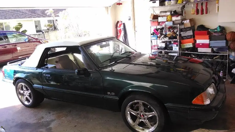

I found the installation cd on ebay. It was around $20. It did take me two days, and it was a learning experience for sure. The top I got from LMRS was marked where it needs to line up on the trim sticks so you get a good baseline install. From there it was a lot of adjusting to get wrinkles out. Even with the time it took I'm glad I did it. Saved a ton of $$ and I can say I have done everything on my car myself.
[URL='http://s841.photobucket.com/user/Mstng93SSP/media/IMG_20140130_174638058_zps3kpgrutt.jpg.html'] IMG_20140130_174638058_zps3kpgrutt.webp [/URL]
[URL='http://s841.photobucket.com/user/Mstng93SSP/media/IMG_20140130_174638058_zps3kpgrutt.jpg.html][ATTACH=full]116519[/ATTACH][/URL]'][URL='http://s841.photobucket.com/user/Mstng93SSP/media/IMG_20140130_174638058_zps3kpgrutt.jpg.html][ATTACH=full]116520[/ATTACH][/URL]'][URL='http://s841.photobucket.com/user/Mstng93SSP/media/IMG_20140130_174638058_zps3kpgrutt.jpg.html][ATTACH=full]116521[/ATTACH][/URL]'][URL='http://s841.photobucket.com/user/Mstng93SSP/media/IMG_20140130_174638058_zps3kpgrutt.jpg.html][ATTACH=full]116522[/ATTACH][/URL]'] IMG_20140205_162609612_HDR_zpswhprwfuf.webp [/URL][/URL]
[/URL]'][URL='http://s841.photobucket.com/user/Mstng93SSP/media/IMG_20140130_174638058_zps3kpgrutt.jpg.html][ATTACH=full]116526[/ATTACH][/URL]'][URL='http://s841.photobucket.com/user/Mstng93SSP/media/IMG_20140224_085525803_zpswq8r40ve.jpg.html'] IMG_20140224_085525803_zpswq8r40ve.webp
