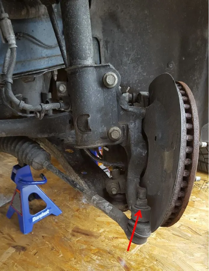

Here is a photo showing the relationship of the ball joint and strut...until you get under there, you'll not know for sure.
Arrow is at the ball joint...the strut is the tube in the upper center of the picture. (Credit AM).

Sorry, I neglected answering your questions---
"That would pull down the fender / tire rod?" The ones I've seen had the wheel/tire way up in the fender well.
"And do you think everything else would be ok?" That really depends on which part broke, the stresses on the suspension when it gave way, and how quickly you were able to get stopped.
"And would that give the impression about the strut?" When you look at the photo, you can see that if the strut or balljoint were to give way, the car would end up in about the same state...that said, I'm with Ragged GT and suspect you'll find the ball joint is the problem.
That’s the tiered end, the ballpoint is behind that
Yup, you're right...that's what I get for hurrying and using someone else's picture.
