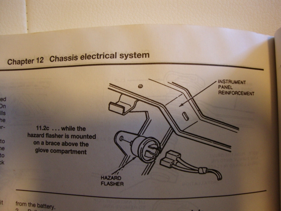

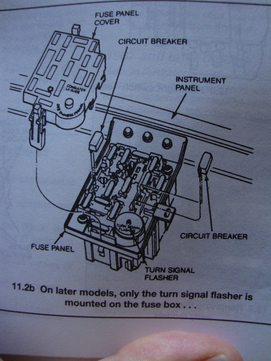

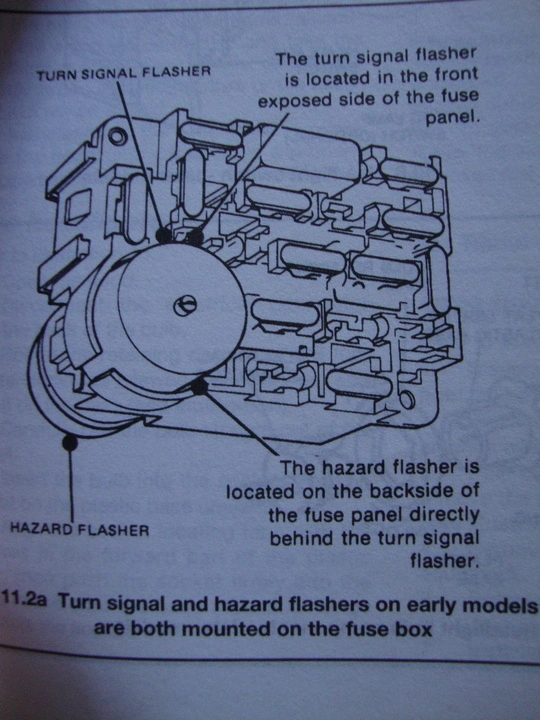

got this right out the book. sorry the pics are so big
this site helps me alot , just returning the favor.
Shot with DSC-W220 at 2009-11-04
hope this helps. sorry i didn't like the way it resized so i left it as is. Oh this is from the Haynes 1979 thru 1993 for mustangs.
