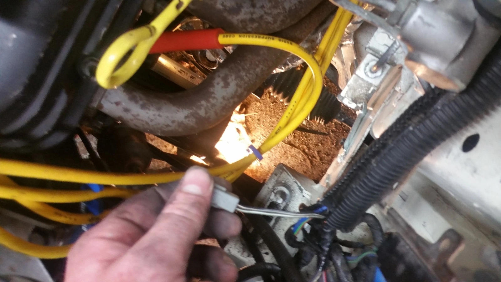

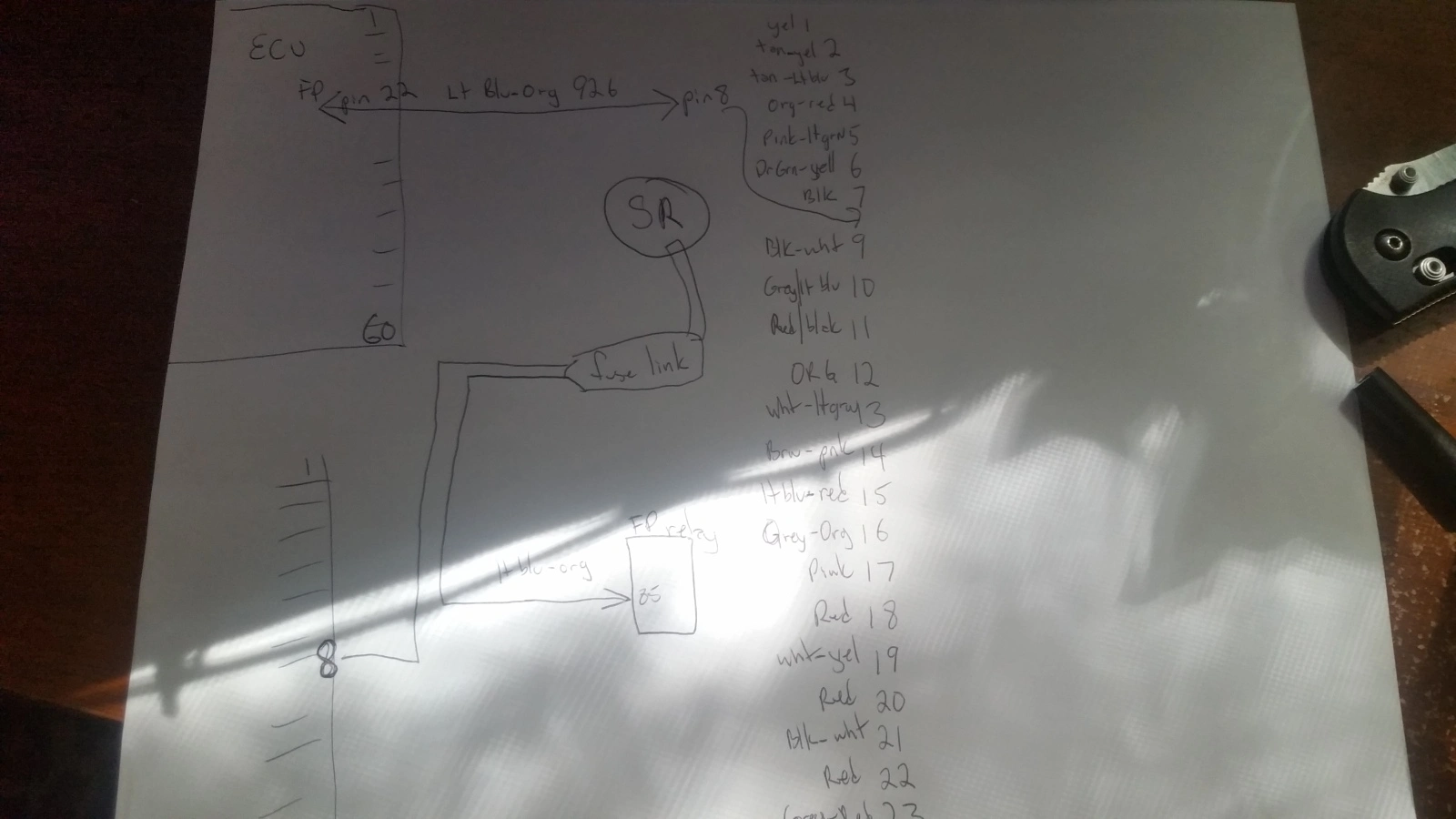

I was not able to find an Orange/blue fuse link for the fuel pump as there was only a cluster of 3. The colors were Yellow, Black/Orange and Black/Yellow? Trouble?

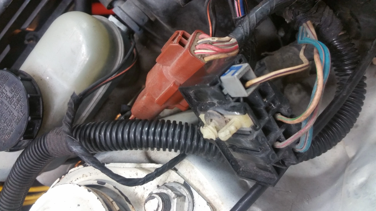

Also, is the STI port supposed to have one tan/brown wire or 2 black wires? I ask because about 2 feet down is another connector that looks like the STI port with 2 black/white wires.
Having a rough time with this car!
Does this connector look right? The "sti" comes out of a sleeve and has a tan/brown wire. There's another one of these sti looking things 2 feet down with two black and white wires.
Also, if missed, I was not able to find the Orange/blue fuel pump. I am concerned over this because this car was in bad hands and it wouldnt surprise me to see it was cut out of the harness. If that's the case, I'll wire it back. Just need to know.
The orange/blue fuse link is what powers the fuel pump. That may be a clue to why the fuel pump runs anytime the ignition switch is in the Run position. Someone may have tapped into one of the ignition switch Run side power feeds or to one of the switched power circuits on the fuse panel.

"The orange/blue fuse link is what powers the fuel pump. That may be a clue to why the fuel pump runs anytime the ignition switch is in the Run position. Someone may have tapped into one of the ignition switch Run side power feeds or to one of the switched power circuits on the fuse panel."
Ok, that would make sense considering all the other things that have been hacked up.
I do have questions following the direction of the charts. I find them a bit confusing but can we see if I can tell the direction I am supposed to be in? That way, I'll be ready when I get home from work for the next mission!
Ok, here goes, My ecu harness is going to have this light blue/orange wire at the end of a plug of where it connects to the dash harness, correct? I need to find where that blue/orange wire has been cut or pulled out of on the dash harness?
Does that blue/orange wire then go to 37 on the ignition switch and out to fuse links on the starter relay?
Whew, thanks
Well, none of that worked out. Either you can follow the instructions or you can't. Thanks for trying to help me.
The first thing you need to do is to peel back the plastic tubing that covers the wires that go to the fuse links. Then locate the orange/lt blue wire. Put a new fuse link wired according to the diagram I posted.
There are two ways to roadkill engineer the fuel pump wiring.
1.) The first is to jumper the red wire (power feed for the fuel pump) on the fuel pump relay socket to the dark green yellow wire (power feed to the inertia switch and fuel pump). Some 91 cars may have the fuel pump relay under the driver's seat, while other late model 91 cars may have it mounted under the MAF. Check the wiring colors against the wiring diagram I posted because the A/C WOT relay is also under the MAF.
OR
2.) Go to the passenger side and remove the speaker and kick panel to access the computer power relay. My guess is that the PO may have attached the fuel pump power to either the switched power side of the computer relay or to the ignition switch feed to the computer relay coil. Either way you will see some wires that look like they are not part of the OEM factory wiring. To access the computer power relay, To need to remove the computer and the passenger side speaker.
Thanks for the extra help on this J. I will follow those down. I think it's more likely the second scenario but will have to check. I am presently stuck with the end of the dash harness. ( I say "stuck" because I don't I don't want to have unfinished business before moving to the next task. Just a couple could make a huge mess!)View My Video
