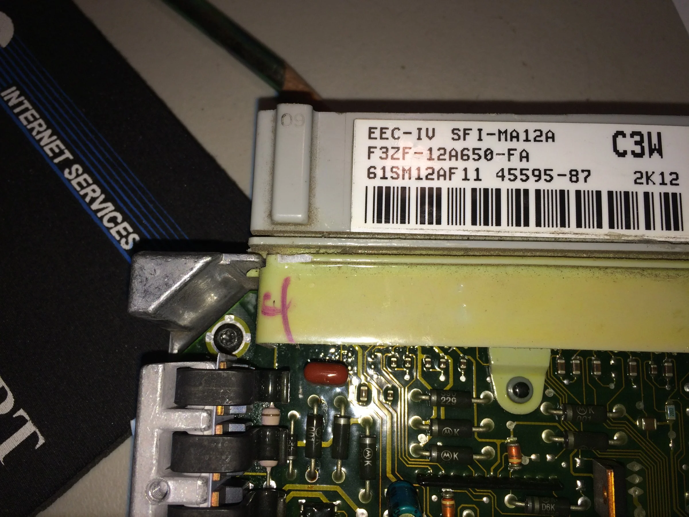

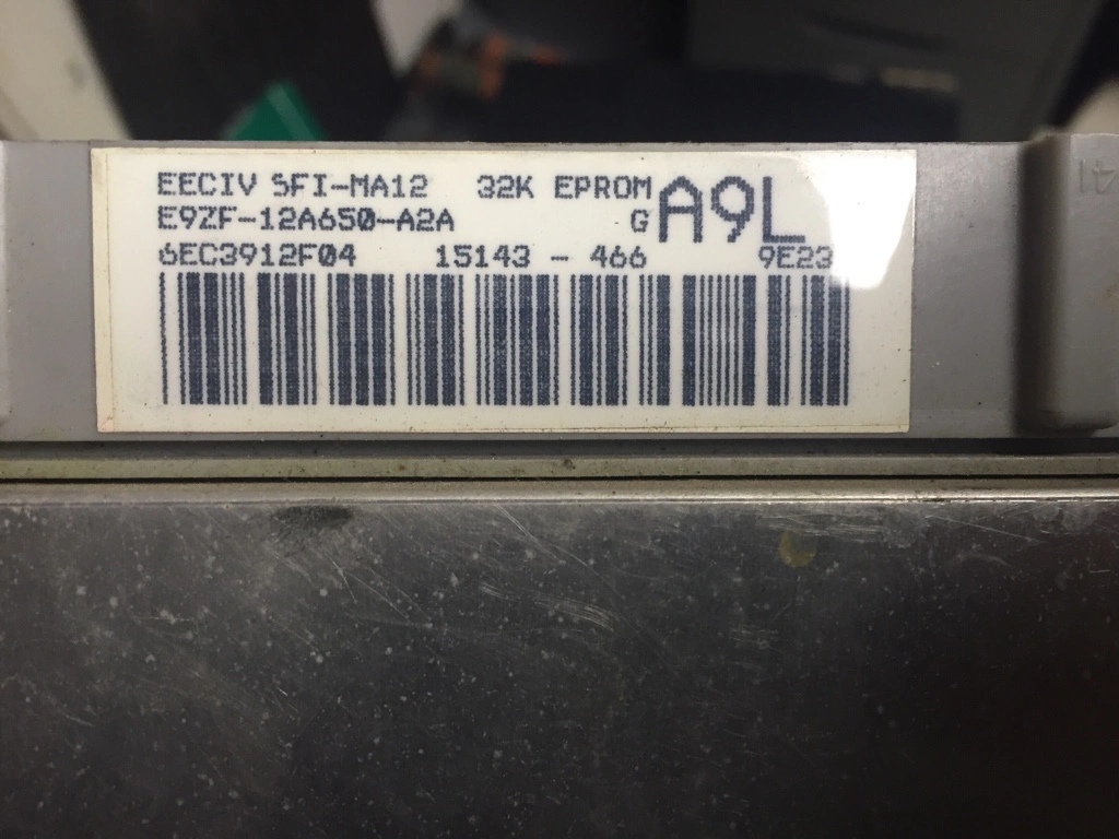

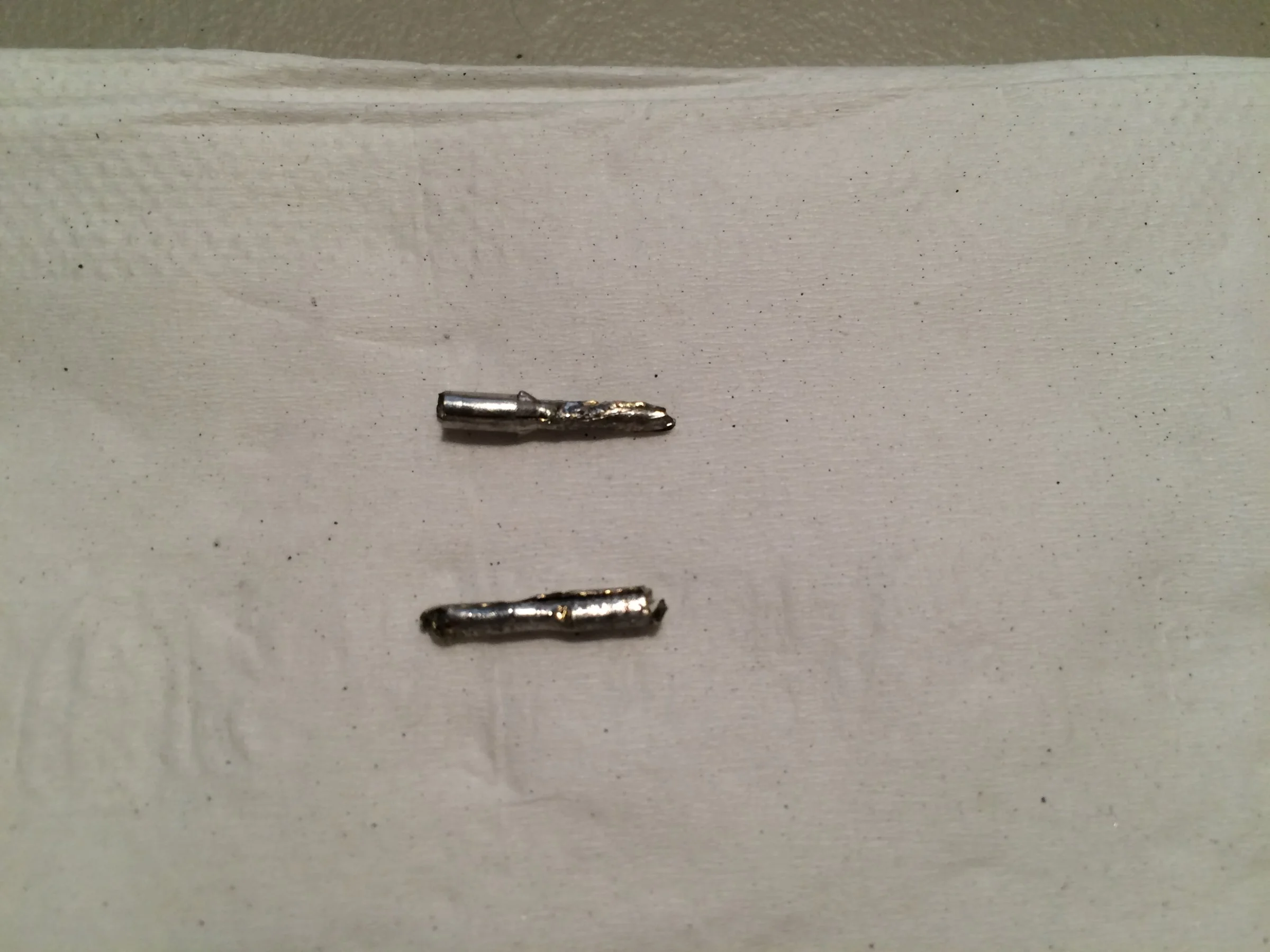

Yes, I attempted to pull a pin that is not used and replace the damaged pin. But, in removing the unused pin I crushed the pin so it is useless. Also, I don't know how to remove the pins without damaging them. If there is a trick to getting the pins out, I'd be interested to know how. I did get the original pin back in the EEC but contact is intermittent at best and I don't want that going on with the computer. In the picture, the pin on top is the unused pin I removed from an adjacent location. I pretty much destroyed it getting it out. The bottom pin is the original. I inserted a stick pin in it ang got it somewhat rounded and back in the EEC but the connection is intermittent, as I said. I think I'd just as soon get a good computer that's right for the car. Thanks for your help. Let me know if you are willing to sell the A9L.

The pins must be desolered and removed from the back side of the connector.
If you are getting an intermittent signal then put the pin back in and solder it from the back side, it may be difficult to get to but can be done...
What pin number is damaged there may yet be an alternative.

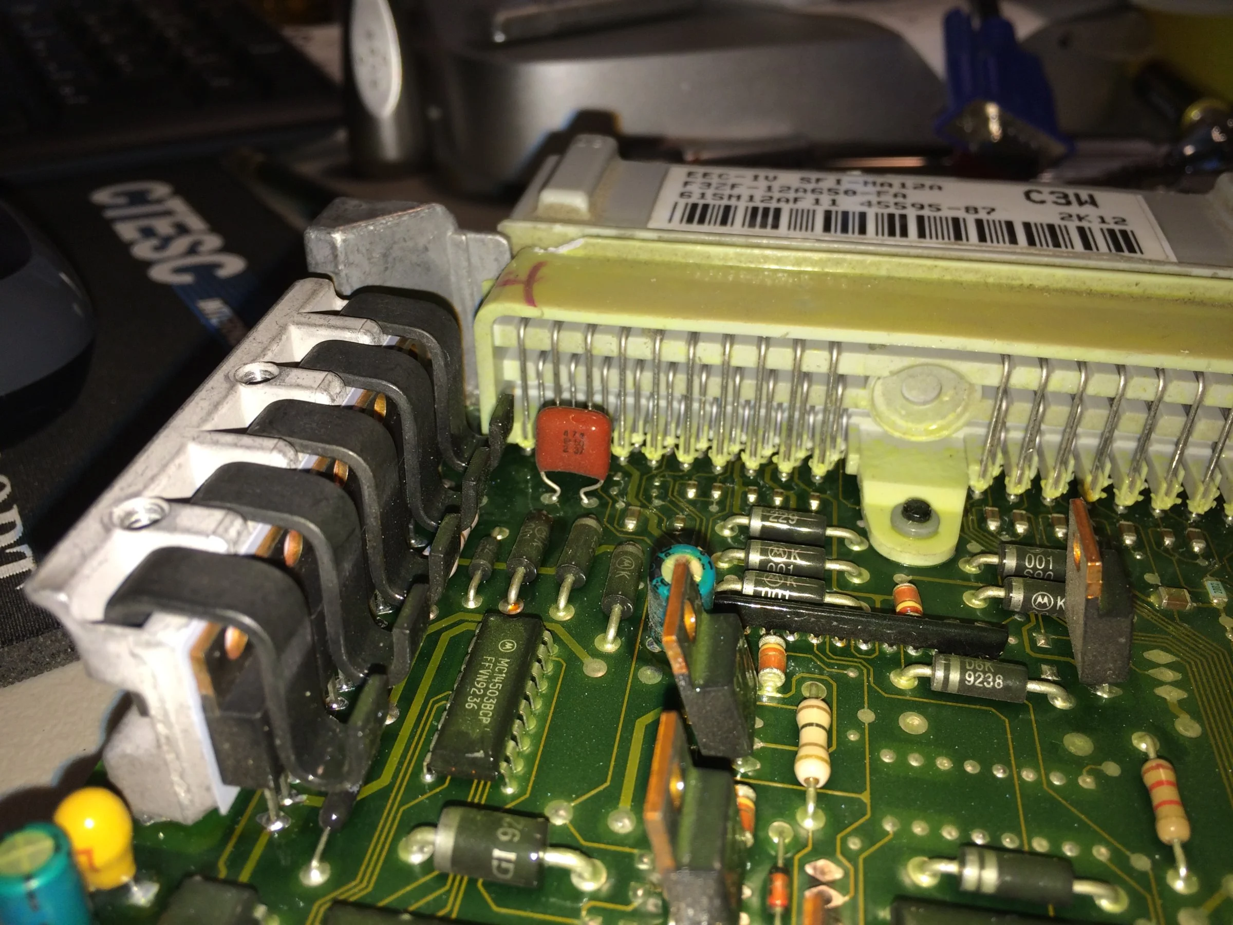

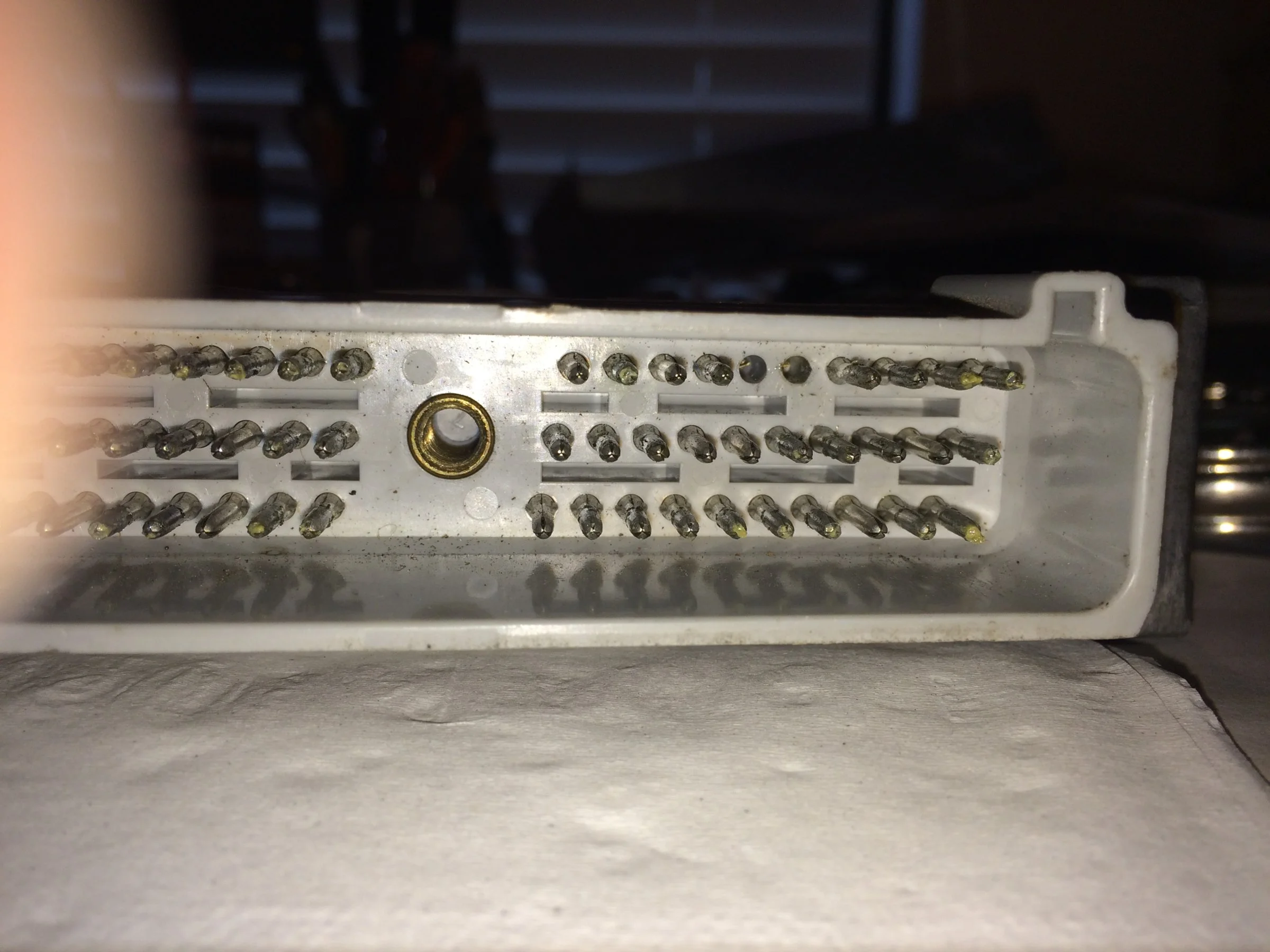

I don't see any way to get to the point that the wire and pin join. The two plastic parts (grey outer and green inner) that house the pins are epoxied and will be destroyed to separate them. I've included pics of inner and outer views.

Pin 45 is for baro correction.
Car should still start.
Solder a piece of wire onto the pin inside the eec run it thru the j-port to the harness and make a temporary connection to the wire for pin 45. If done correctly this could be used as a permanent solution.
