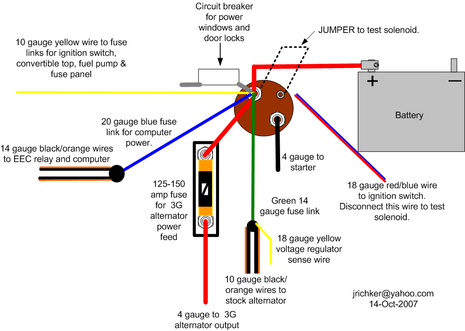

Stupid question, in step one what screw am I jumping to the part woth the battery wire on it?
@87GTForSale
There are 3 screws: one with a big red wire that goes to the battery and a small wire red/blue wire that goes back into the wiring harness. Those are the 2 wires that get jumpered together to crank the engine. Just remember that you need to have the ignition switch in the Run position when you do this step.

Thanks, much clearer now on where to start.
