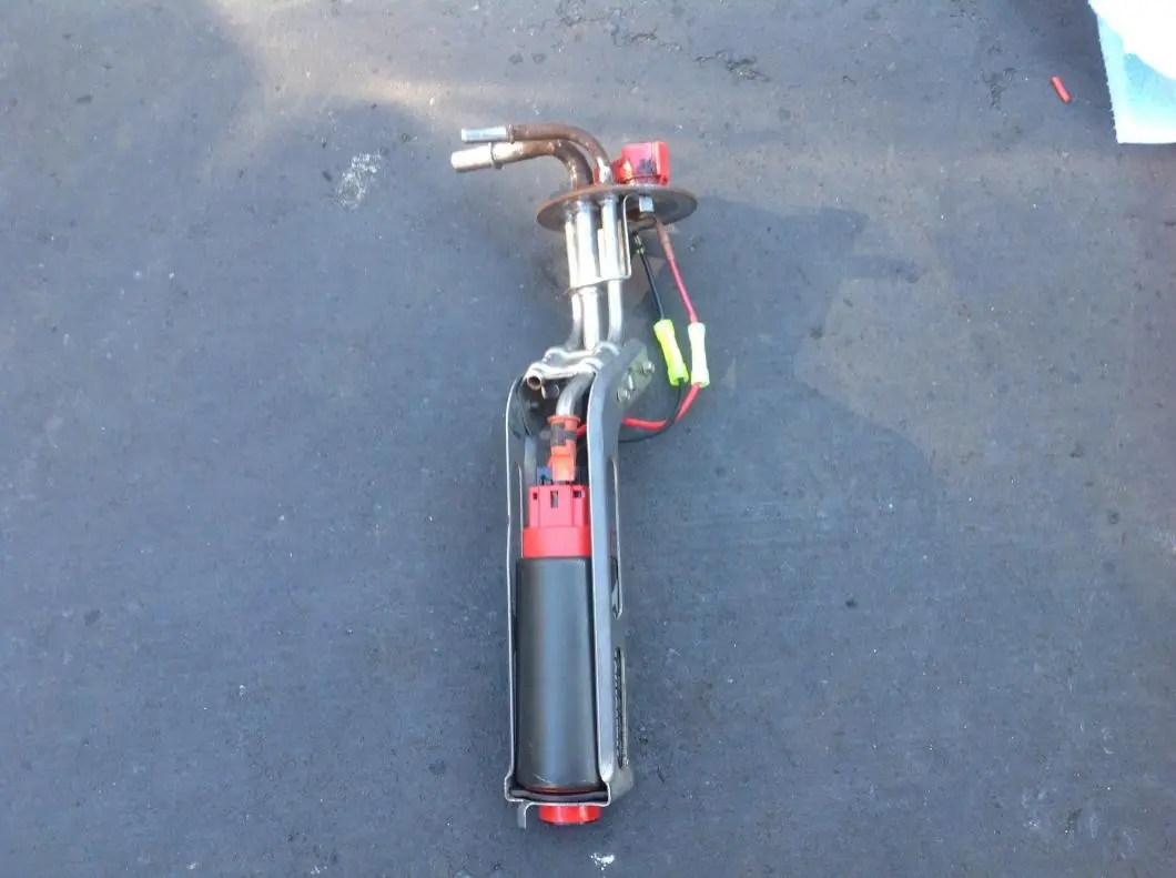

When fuel level in tank gets below the top of the fuel pump, temperature of the pump would rise if it were not for the "duckbill" on the end of the return line which sprays fuel on the pump to keep it cool.
A few hours of highway driving seems to indicate that this could be the issue.
The little orange thing with the clamp on the top of it at the end of the return line is the duckbill spray nozzle.
How many just throw this away not knowing it's function?
BTW, never use butt splice crimps to make the connections shown. Solder & heat shrink or heat shrink crimp terminals only.
Reactions: senorpavo
