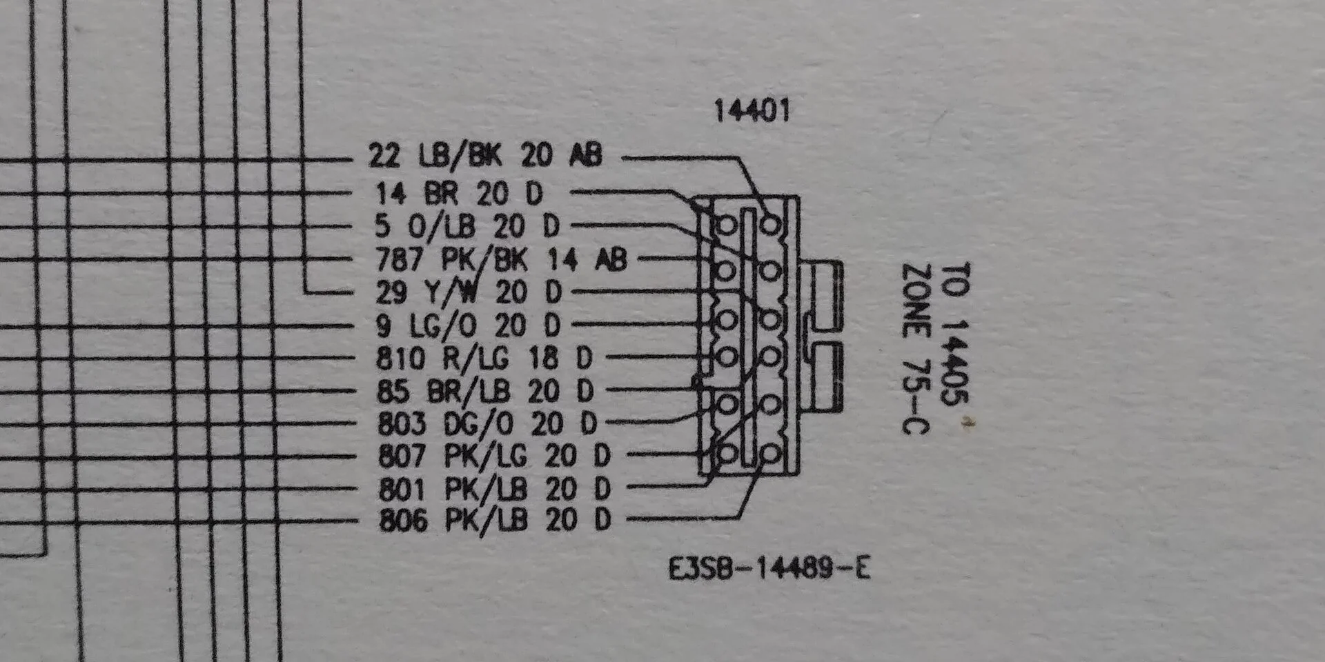

Interesting. I’ll take a look. Would you happen to know/remember which plug the fuel pump is at the kick panel?
I believe it was a rectangular connector with 12-16 pins. Not 100% sure off the top of my head. I used the wiring diagrams in my Chilton's manual. What I like about them is they show the connector shape and wire color and size. At ECM, radio or other similar type parts they list what each wire does as well.
My car is a 90, so some wires could be slightly different.
I can check my manual and see if I can get a pic.
Thank you very much, I greatly appreciate it.
Mines a 1993 if the manual happens to reference different years.
This is the connector in the driver kick panel. My manual covered 89-92 but the connector and location of the wire within the connector you are looking for was the same for the various years. The wire number you are looking for is 787 (second from the top on the left). The wire number changed for the various years but wire location in the connector stayed the same.
Keep us up to date as you solve the problem.
Thankyou for taking the time to post the picture. I will check to make sure the pin has good contact.
