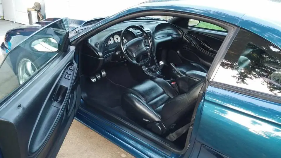

Before when I got my 98
After I got done with new ACC Carpet, a full black interior from a donor car and TMI foams/vinyl (yes vinyl) upholstery
