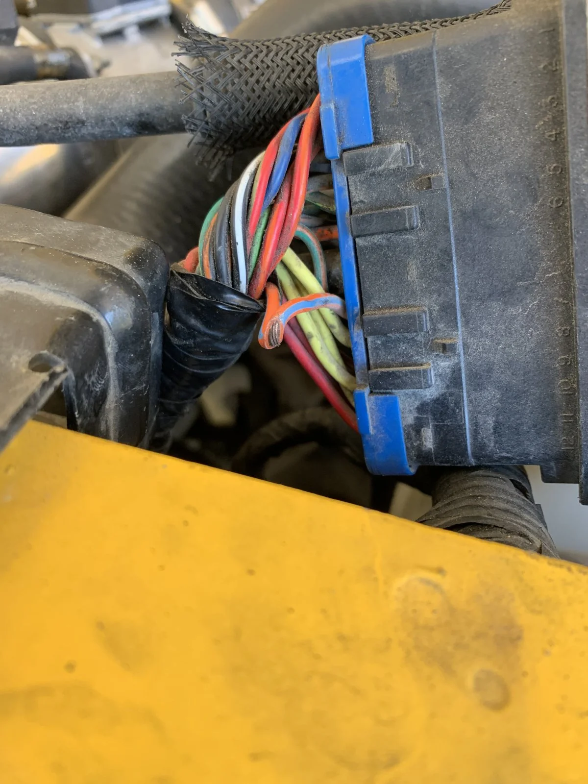

Would something like this cause the fuel pump not to prime would that be enough to cause a short ? If so do I need a new harness or can it be fixed?
If that were touching metal it would cause a short, but since it's not it wouldn't. Though depending on how broken it is, it could cause on open circuit causing something not to work. That could easily be fixed with some solder and heat-shrink tubing.
