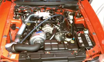

On my stock motor at the time I had a p1sc procharger and made 440rwhp on 11psi and blew it up 3 months out of the shop biggest waste of 10k that lasted 3 months lol
What the hell cost 10k? My whipple blower/manifold with all the goodies wouldnt cost 10k. Either you got ripped hard (and consitering it blew up....Im leaning that way) or just bought some really overpriced stuff.

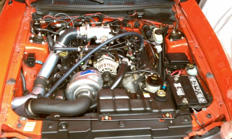

I'm in the same club, bro. At least I got about 18,000 miles out of my original motor until I blew her up with my Paxton 2000, lol.
at least u got 18000 mine at the time and still is today not a daily driver but I ran mine hard street racing and grabbing gears real hard to feel the power and see what I could beat on the streets
