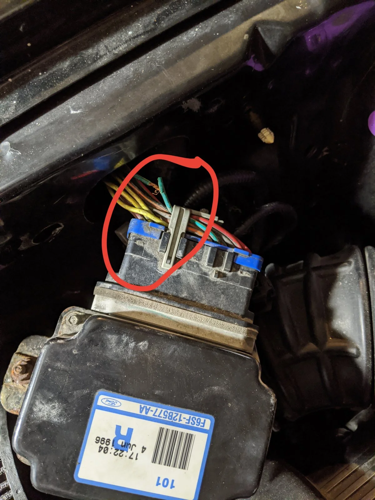

#5 pin is not red it's (circled) green with yellow tracer and it did not start applying 12v to that wire
Sorry. Typo. CCRM pin #5 should be DG/YE.
Did the fuel pump RUN when power was applied to pin #5? Did the wire spark at all? Did anything change at all?
What is the condition of the CCRM connector when disconnected? Any corrosion? Any bent/pushed pins?
No bent pins or corrosion. Pump did not run when power was applied to that pin #5 and I checked voltage at the rear wiring and it's getting 11.9 with jumper at the wire but the pump is not running.
Since the voltage at the trunk mounted IFS switch goes to battery voltage when external power is applied to CCRM pin #5, this proves we have the correct pin/wire.
