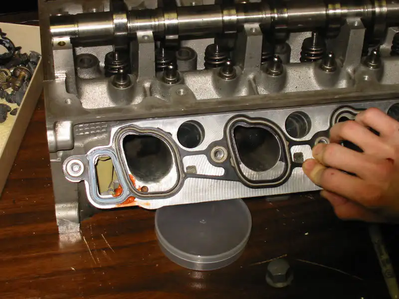

here is a pic of a npi head with a pi gasket
