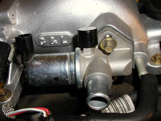

It's very easy to remove, I replaced it in less than 10 minutes. It's held on by two 8mm bolts on the front side of the upper intake plenum. It looks like this:

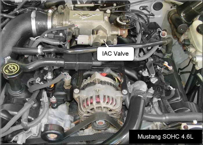

And is located here:
