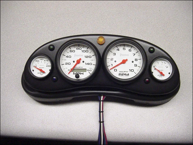

if they can't (won't) do anything for us, i guess i can go this route, with white face gauges and silver edging:
http://www.florida50.com/1994-2004-instrument-clusters.htm
things are damn expensive tho

I believe you just swap a few wires in the plugs. Or I might be thinking of a '96-98.
96-98 is just a few wire swap
99+ would be a bitch IMO. it has PATS built into it which is fords passive anti theft system whitch does not allow the car to start without recieving a signal from the chip in the key. also has digital odometer with mileage stored in it.
to swap one in you would most likely need to use the 99+ ECU also with the wiring and i dont even know if the ECU could be tweaked enough to run the 5.0
better off with a gauge overlay and rings or the florida5.0 cluster

Sounds like it would be easier and maybe cheaper to just get a '99+. lol
