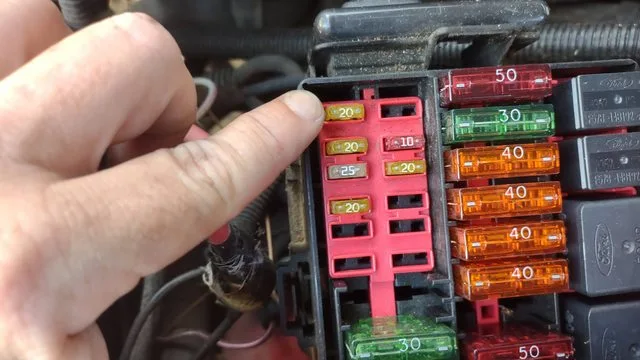

  • Checked 20amp fuse for pump under the hood which is fine.

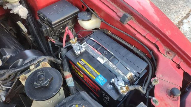

  • Installed New Battery and new terminals. Double checked that no ground wires were missed.

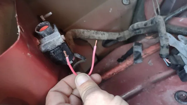

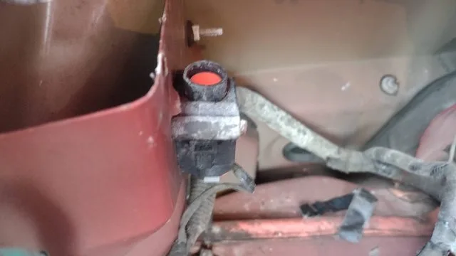

  • Checked inertia switch in the trunk, reset, and bypassed with a jumper. 12.8v in and out

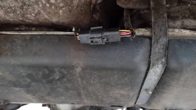

  • Checked my voltage on pump harness at the rear of the car 12.3 volts while in the run position
  • Dropped the tank drained old gas and replaced the fuel pump.
  • Checked voltage on the pig tail that plugs directly into the pump getting 12.3 volts hitting the pump while in the run position

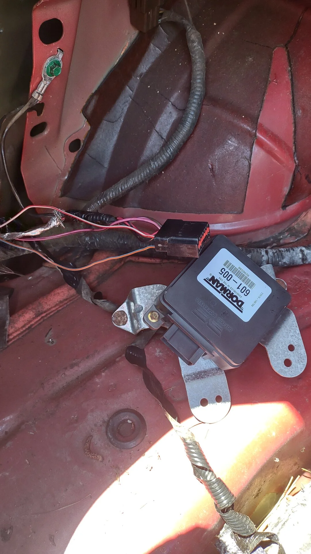

  • Replaced the FPDM

After I reassembled the pump, put the tank back up, and put 5 gallons of fresh gas in the tank I still have the same issue. If I lay under the tank and have someone turn the key I can hear the pump click but it does not run. The odd thing is if I disconnect the FPDM and jump out the harness the pump will run and I get fuel to the rails. I replaced the FPDM and still have the same issue, pump clicks but will not run. Checking the harness I am getting 12.8v on the constant from the inertia switch, the main ground is fine with a good connection. The only issue I cannot figure out is the pulsing ground to the pump. Everything I have seen says that I should see my 12v while in the run position which should drop to 0v while cranking and return to 12v when not cranking. I have 12.8 in the run position 10.2 while cranking and returns to 12.8 after cranking. Im wondering if I am having a grounding issue on the harness from the FPDM to the pump housing or in the housing itself.
