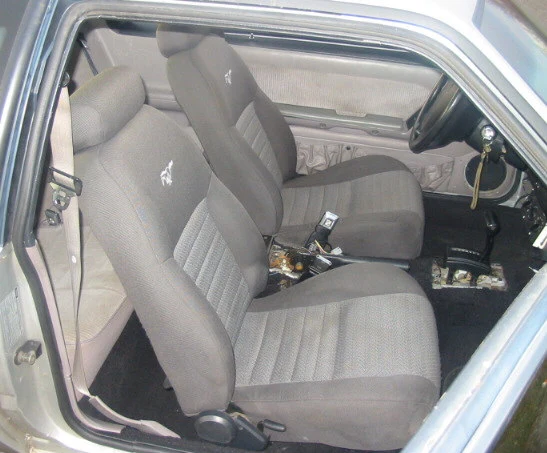

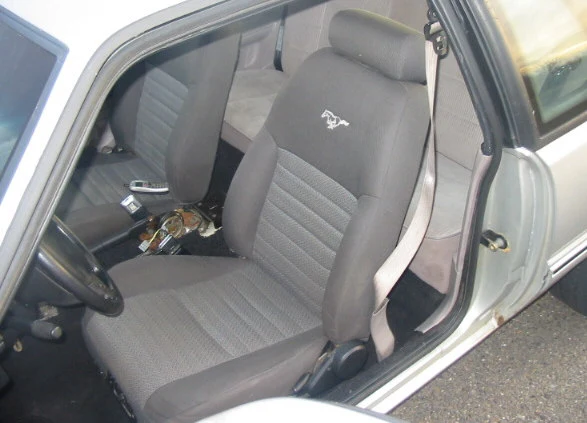

I just put some from a 2002 in my car. The fit perfectly, just sit a bit higher. I made some extension wires for the power that plugged into the seat harness and into the lumbar plug under the seat with some spade connectors. That way I didn't have to cut any wires and can easily remove them. If they sit too high for you, you can use your old rails, but you will need to use some washers as spacers since the seat bottoms are not straight.
Here are some pics....conversion still in progress.
are those seats much more comfortable than the stock seats? I actually don't mind the stock seats, but mine are leather in my GT and the drivers seat is torn to hell and it is kinda uncomfortable cause it's all ripped, etc.
After driving on them for a couple of weeks, I prefer my 87 GT seats, as these feel more like my old LX seats that came in the car. They are nice, but I might in the future (when I have a lot of extra cash) get my GT seats recovered in leather like the newer seats. But I really like the way the rear seat looks with the carved out seating surfaces vs the flat stock seats.
