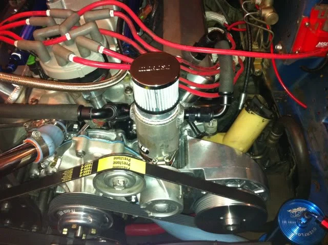

I like the tensioner relocation bracket that I got, but that's without using the stock alt. bracket:
Engine Belt routing with supercharger and smog/ac/ps delete
