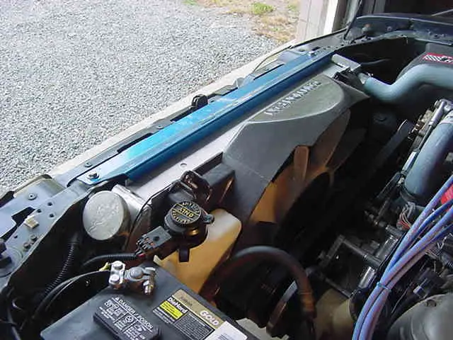

A friend of mine just bought a coupe and it has one of those AC idle pulley replacement things on it...it is the most ghetto looking part i've ever seen. Sure, it looks like billet aluminum, but it's just a big rectangular slab of aluminum with a pulley in the middle of it that bolts in place of the compressor. It looks completely out of place and just plain old cheap.
