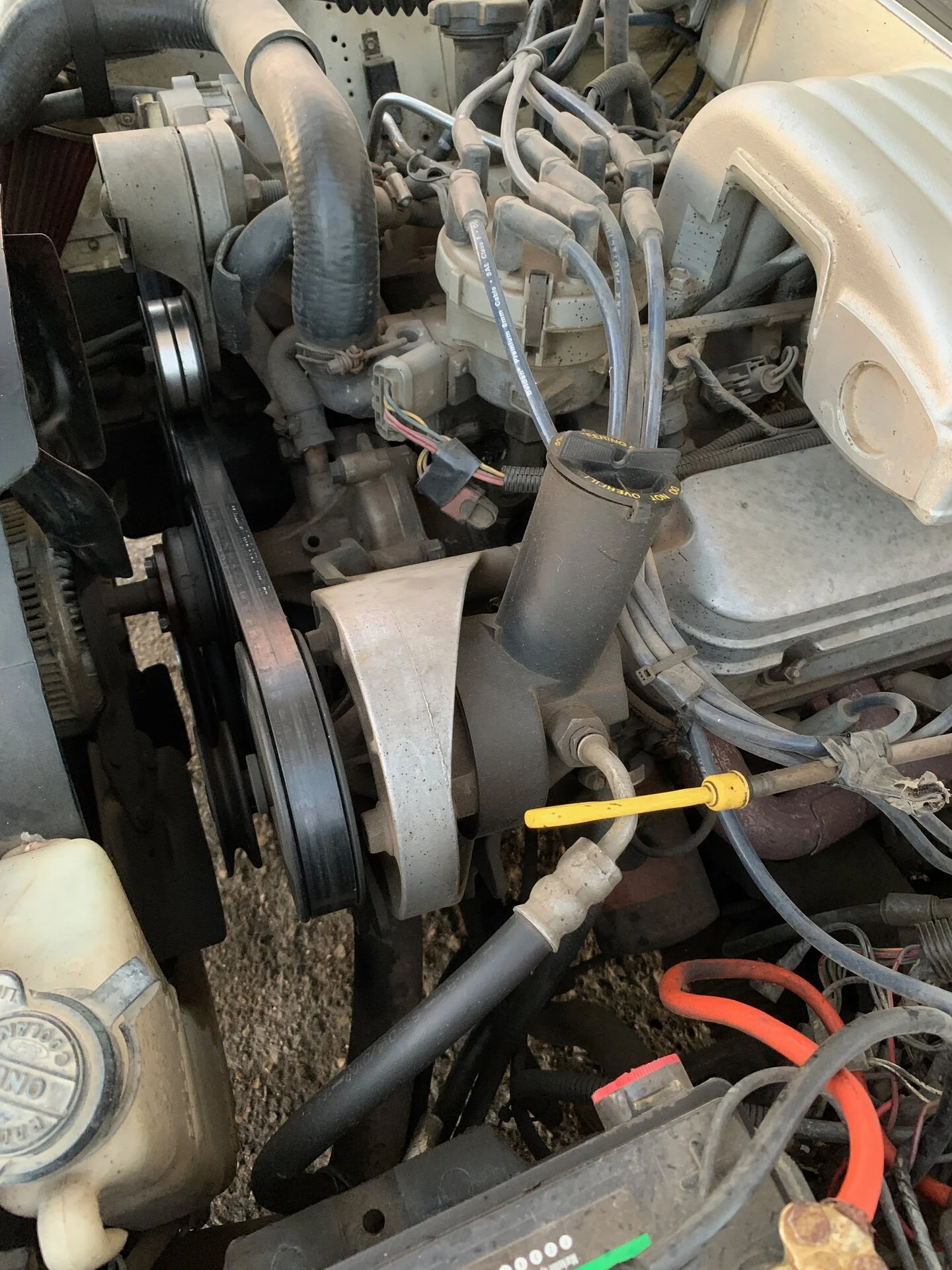

I would love to put the a/c back in. Just not sure what’s all going on with the PS being moved and all. Guess I’ll have to figuout how to get at the controls and see if the door moves.
What is going on with the ps being moved is someone removed the ac compressor and then moved the ps pump to the location where the ac compressor was. This is where the ps pump is on factory non ac cars. You just need to get the ac brackets and move the ps pump back down where it belongs and then put the ac compressor back on.

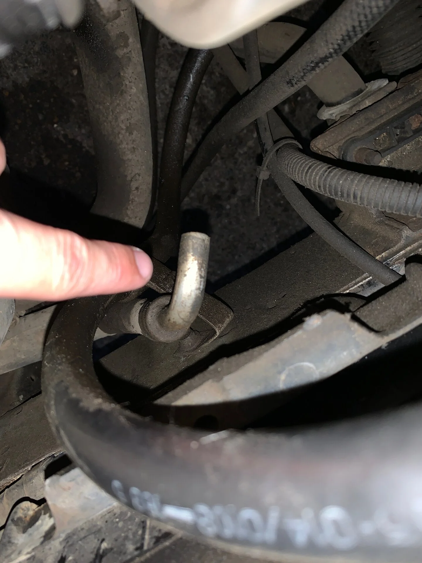

Got the boy to snap this pic. I’m pretty sure that’s a A/C hose

Ford Racing A/C delete. Common setup. You just need to track down the factory A/C brackets. Or buy this kit
Not gonna lie. Putting AC back on will not be cheap. I'm in the middle of doing it and it's a PITA, but worth it.
The kit that is currently on your car to move the PS pump up is this kit

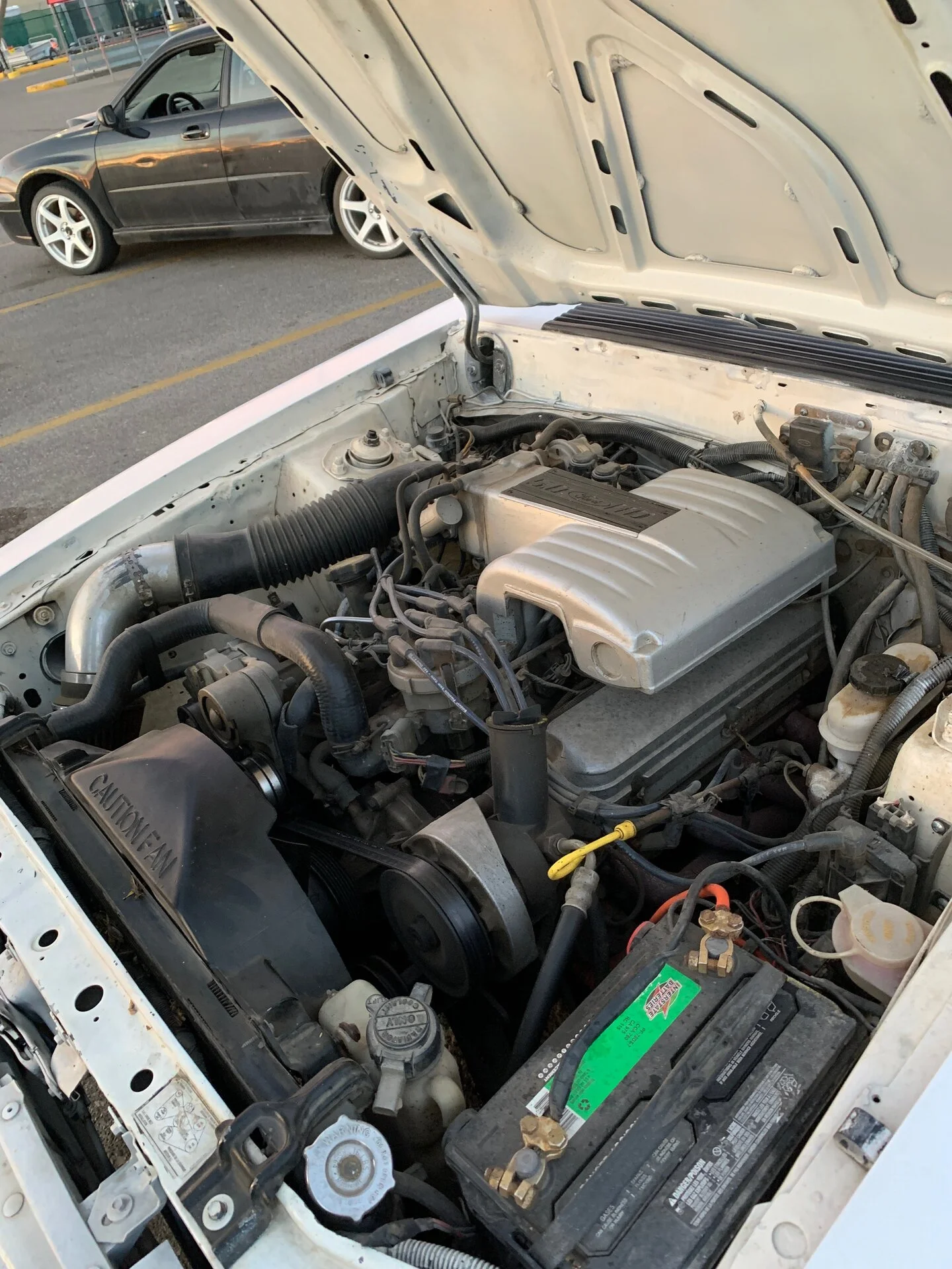

First thing i would do is find a stock air box and add a K&N panel filter.
Looks like the silencer may still be in the fender, you can remove that (but i'd save it).
Also, hard to tell, but it may look like your inner fender wells are missing. Which is fine if you don't drive it in the rain or dirt, but you said you drive down gravel. If it is indeed missing, replace that too.
Then worry about the AC.
Because that intake is surely sucking up dirt.
