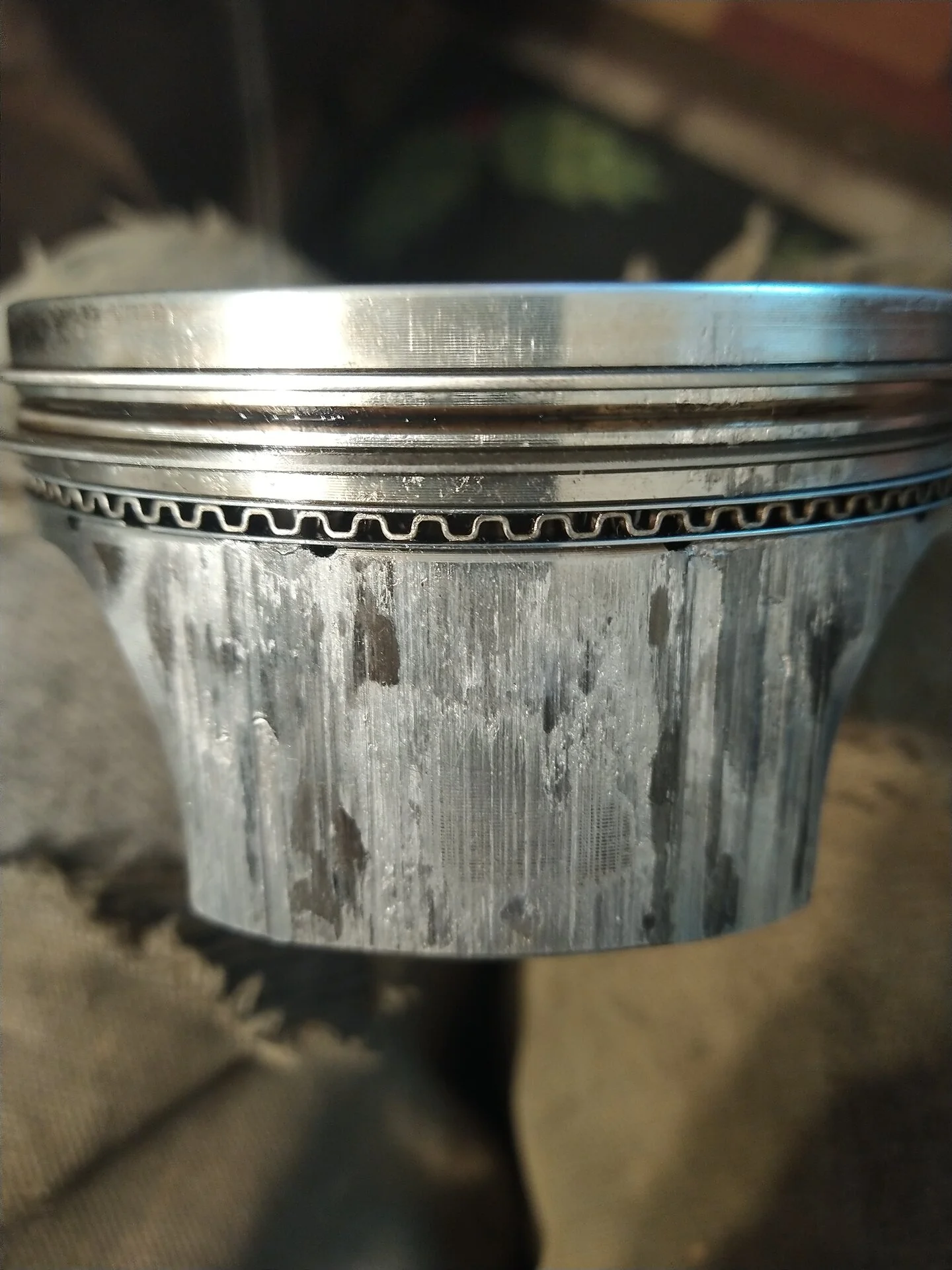

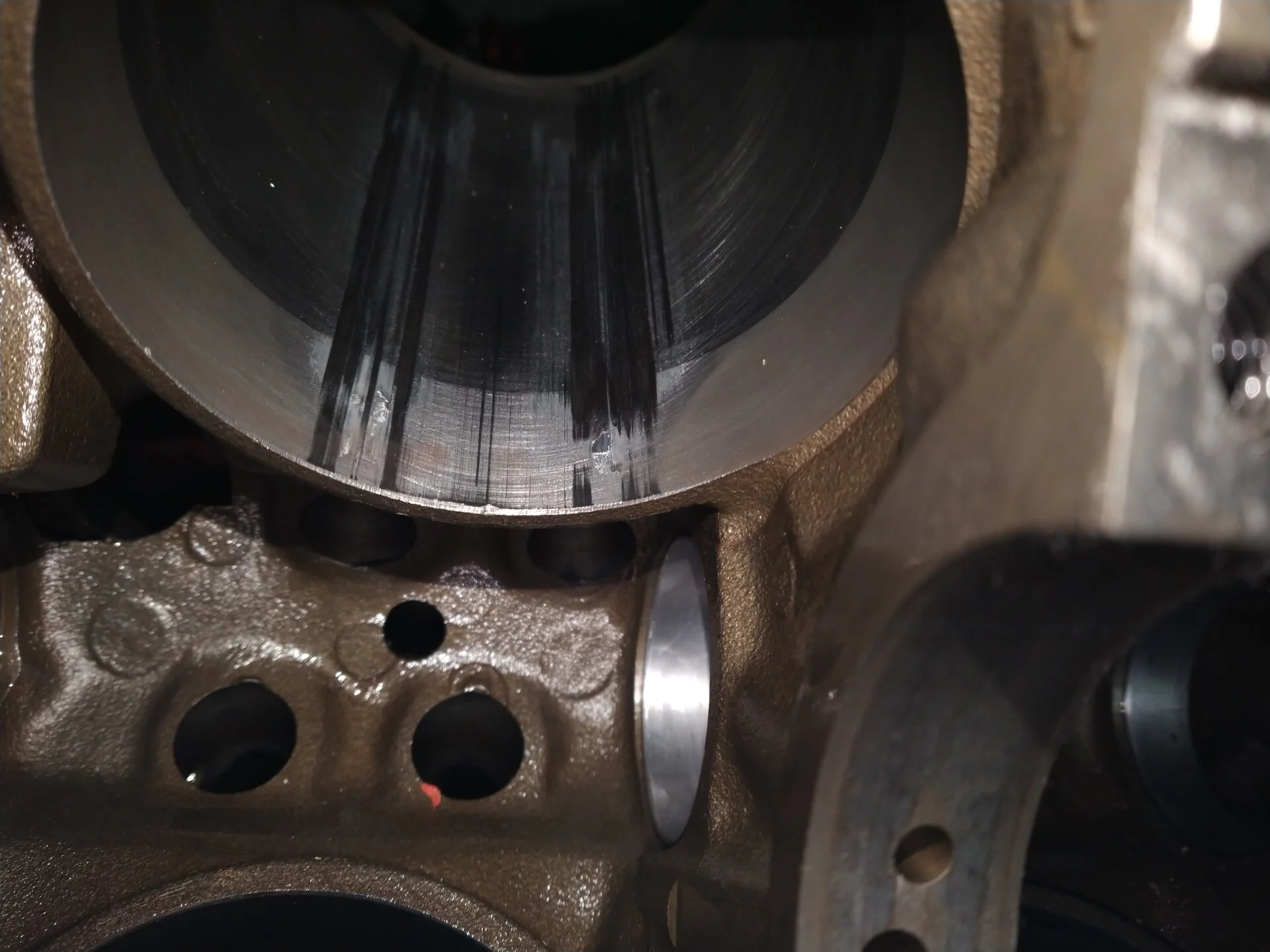

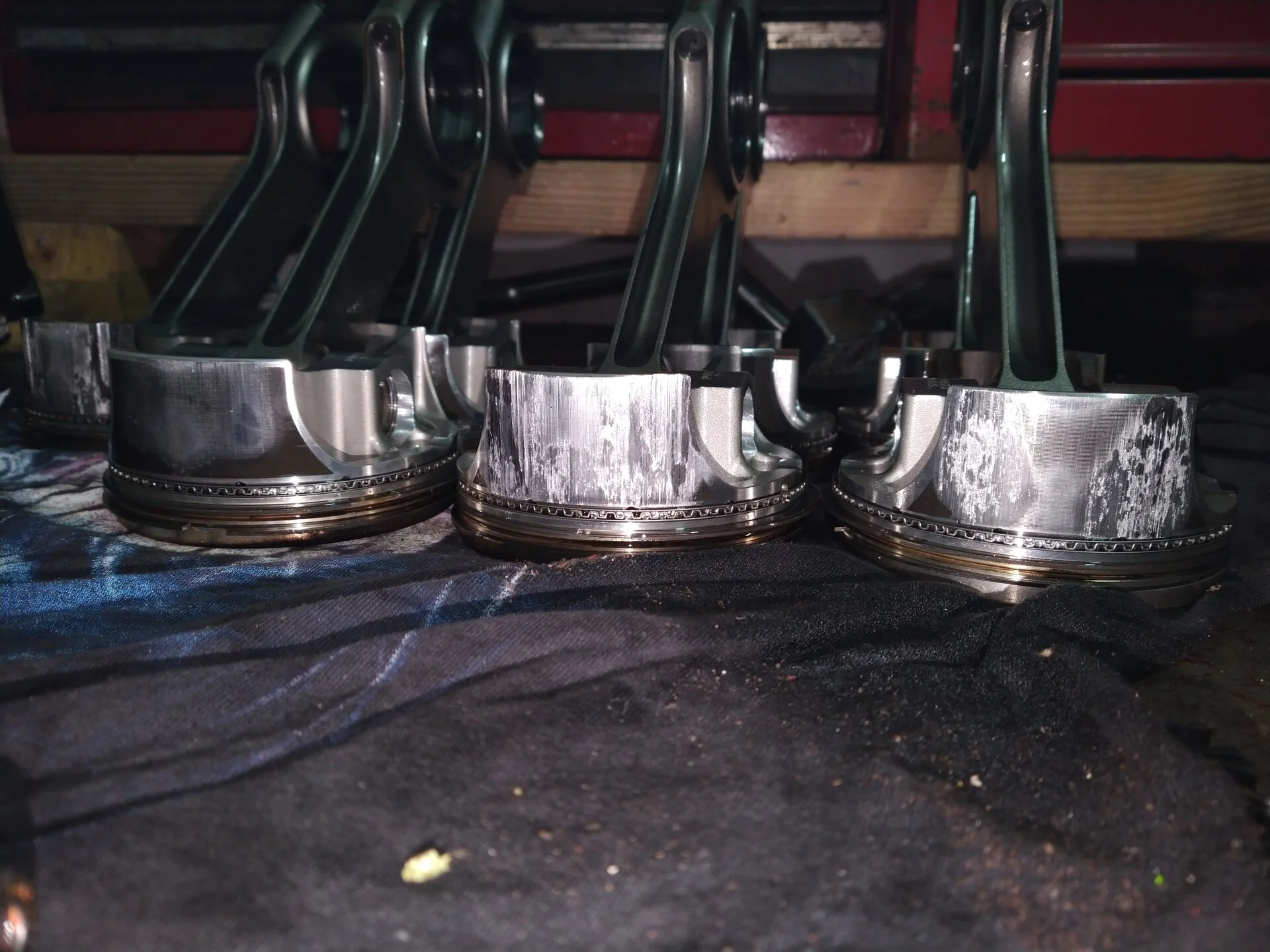

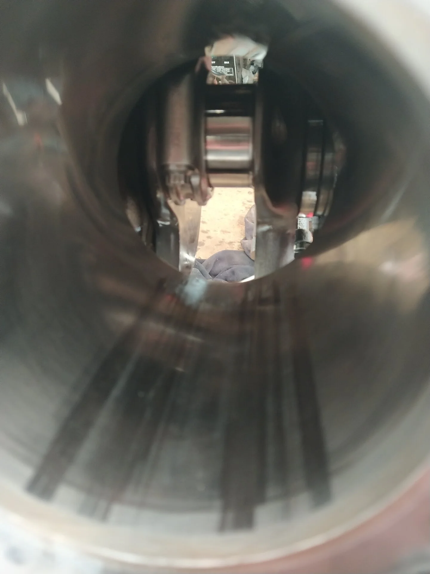

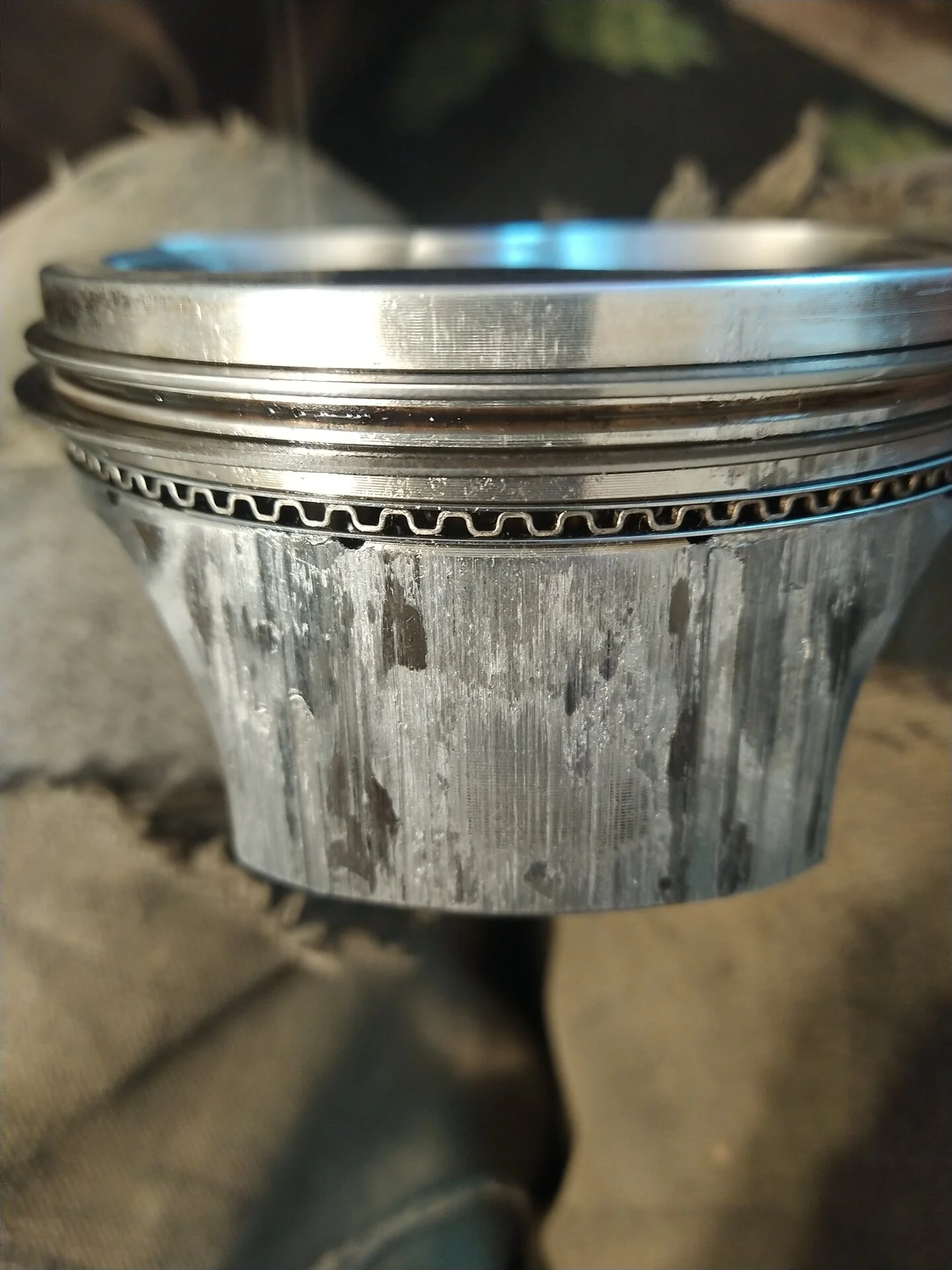

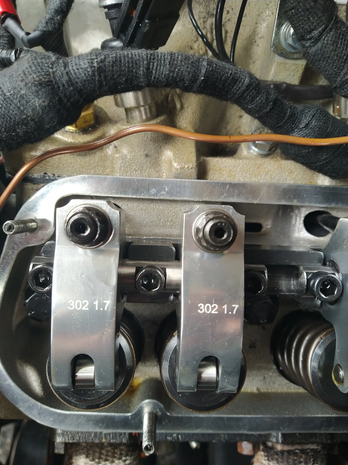

I paid $8 grand to have a 351w punched into a 408w by a veteran in the industry and like all veterans they eventually drop off and make mistakes..

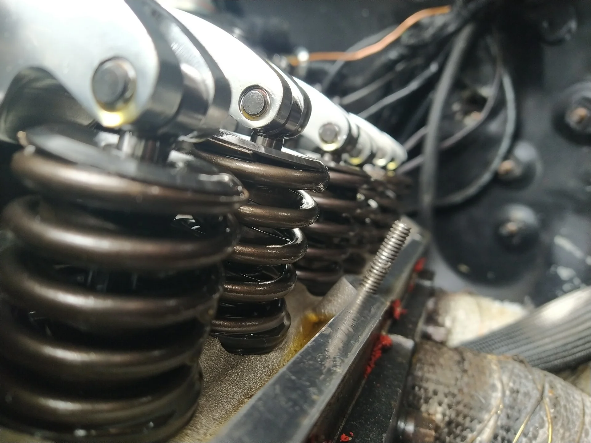

At first I thought the noise was exhaust related then Full roller rocker to guideplate noise issues as the noise went away when warmed up;- so it seemed.
I was driving in my ride and I heard like a rattling through the shifter in 3rd and when cruising in 5th it sounded like I had my timing too far advanced but dont seeings I have a Quarterhorse setup I adjust my timing the best way and leave the distributor at 10* btdc.
Never thought about piston slap until I was coming off a descent but gentle run and coming off the exit my engine sounded like a sewing machine.I thought roller rockers are loose so I bought 1.7 ratio shaft mounted rocker arms and installed them and the noise was still there and the longer it ran it got louder like a diesel truck engine....
Shut it down and pulled it out and pulled it apart......It seems even a veteran in the industry cant be trusted to do the right thing as he didnt even chamfer the bottom of the cylinders and the sharp edges gored and scored 5 out of 8 pistons to death with the remaining 3 ready to join them....
Heres a video of how badly the pistons were loose in the bores....It seems a veteran in the industry not only cant chamfer cylinders but they dont know the difference between 4032 and 2618 alloy pistons as it appears my cylinders were prepped for 2618 pistons yet theyre the high silicon content 4032 alloy pistons that hardly expand....
View: https://vimeo.com/688536226
Im so mad I just want to show up there in the morning and clean some clocks...Its not bad enough I got bent over the barrel and overpaid.IDK how it works in this forum so Ill leave the name of the shop out of it but if anyone wants to know and its cool Ill tell as I have proof of everything they did wrong and ripped me off of way beforehand which enacted me to start a small claims case against them and that was for way lesser things ....This just escalated the deal by 10 fold now....
I hope all turns out good for you but like Bullet347 stated blowby isnt good........Neither is putting trust in someone else like I did...What sucks is Im quite capable of building engines but when the pandemic hit my business shot up and I decided to give a local shop/race engine builder a lil business and boy did it come to bite me...
