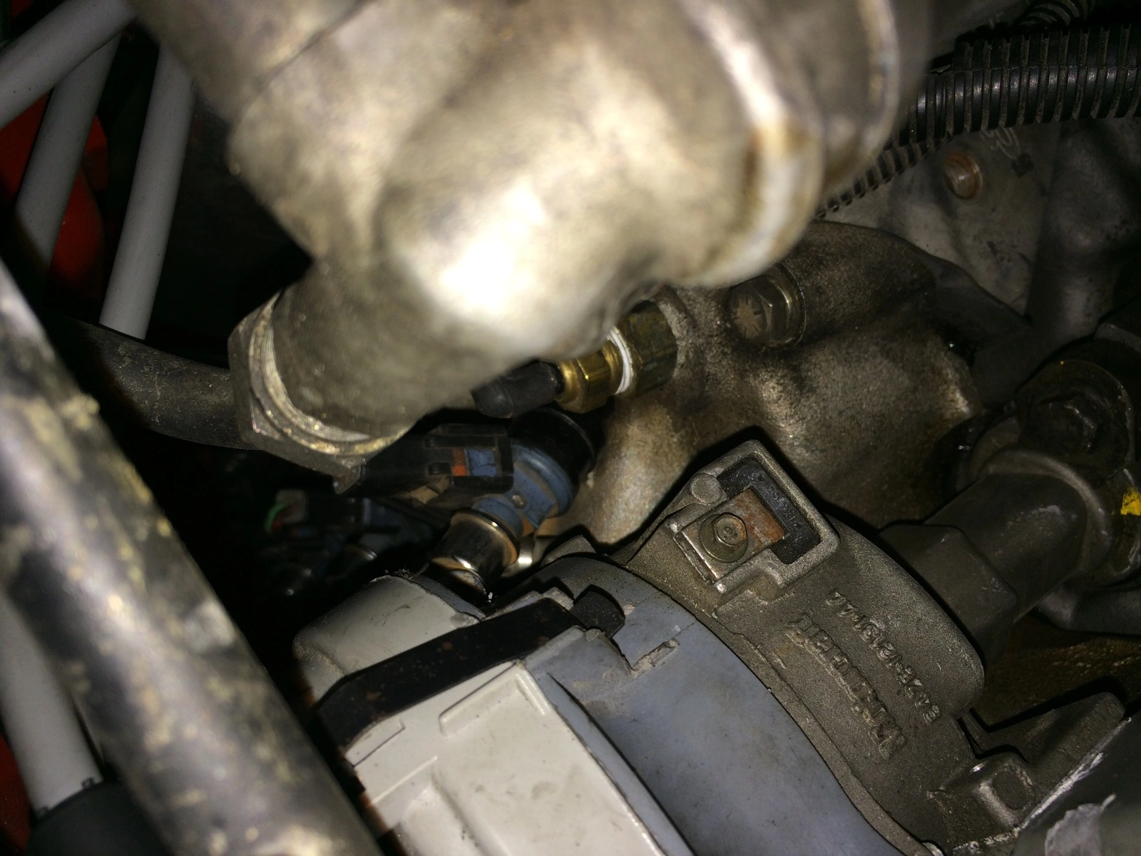

No worries I'm going with the Bama until I get it up to the dyno in a few months. Anyone tell me what size these injectors are? #24 or #36
Why do you ask?
