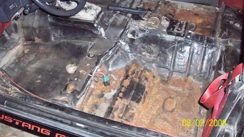

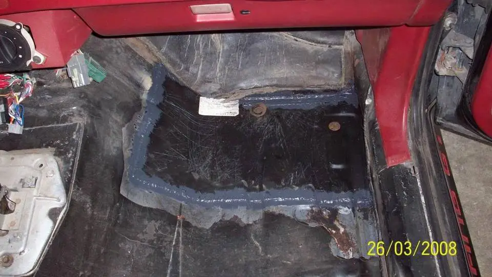

ok, these are the pans before...

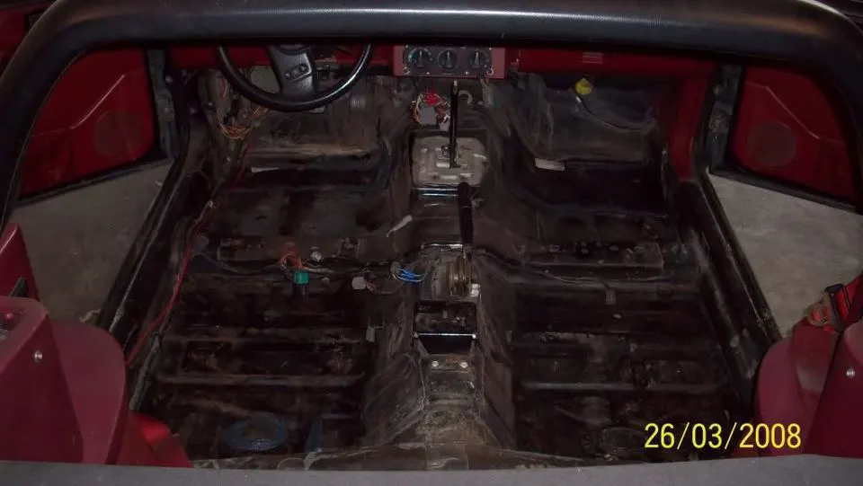

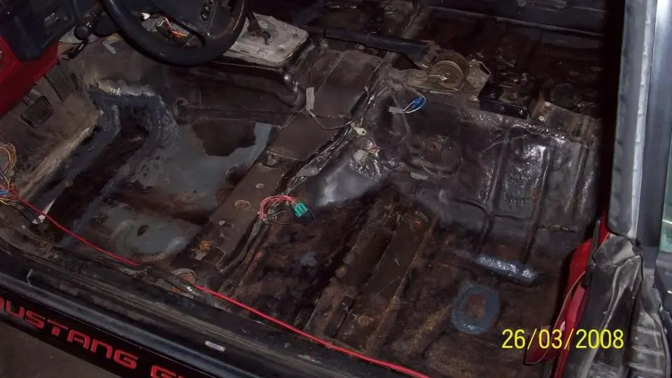

and after...
ok so i started to put the interior back in starting with the center console and everything was going smooth till i realized that i forgot the light that lights up the PRNDL in the shifter. so i pull everything back and snake it out the hole and now the light wont work. it worked last night so i think i bumped it and the 20 year old bulb poped. anyone ever change it? how does it come out?
also i started to put the black hole in under the radio and noticed that it had two bolt holes but for the life of me i cant find where it bolts to.

Your orignal floor pans look mint compared to mine... I'll be doing this project soon. What guage sheet metal did you use? And did you remover anything underneath before welding.. ie brake/ fuel lines?

i bought a pan from lmr and my brother called in a favor to a friend so im not really sure what he did. He did tell me that to take the whole pan out that it would have to come out from the bottom. that part that runs from one side to the other is some kind of structual brace.

the car orig. came from FL. nothing like salty air to do wonders...

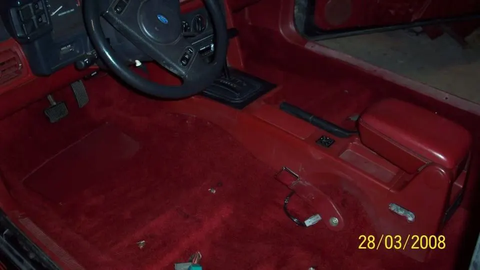

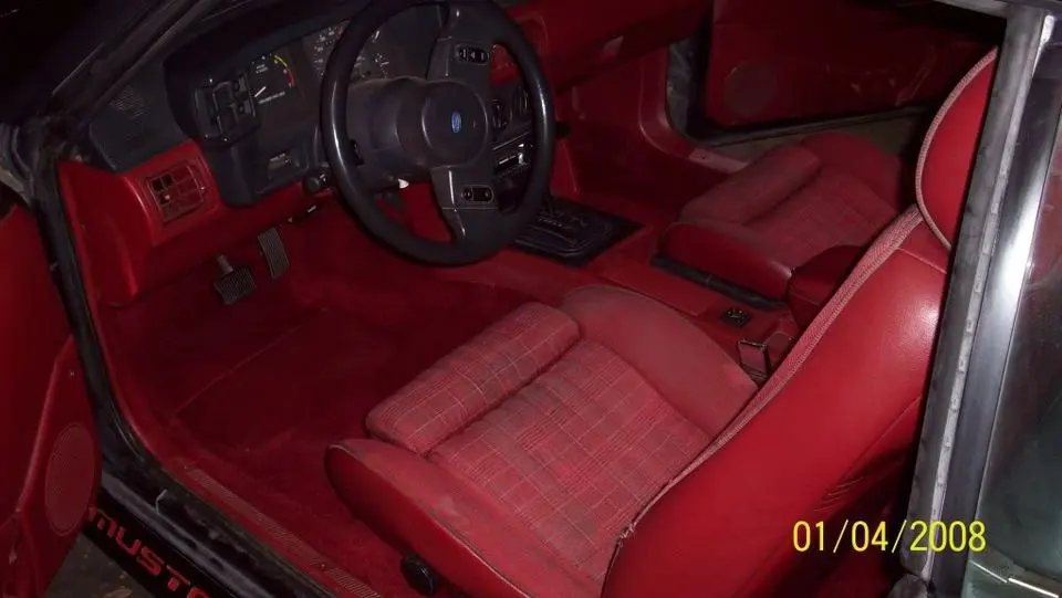

I think that im ready to put the seats back in...
broke one of the sill covers (drivers side) looks like im in the market for them now.
Ill dig around for some simple green or someting that i can use to wipe everything down and then put hte seats in with the little time i can get between other things.

YEAH!!!!!!!!! i now have a happy car!
I sanded some crud off the power lumbar connection and now they both work, kinda cool even though i never mess with them. the only thing i wasnt able to get to work was to make the dome light come on when the drivers door is open. Its not the switch, the binger works fine. Now i need to take the doors apart and fix the speakers and recover (or rebuild) the seats maybe i can have them steam cleaned or something.
A few years ago i found some seat bolt covers on ebay that went right over the fronts but arent there sposta be some for the rear bolts? The carpet with the mass back is deff. the way to go.
Things fixed this project - rusty floorpans, bad fuel door switch, loose trim, nasty old carpet power lumbars in both seats.
