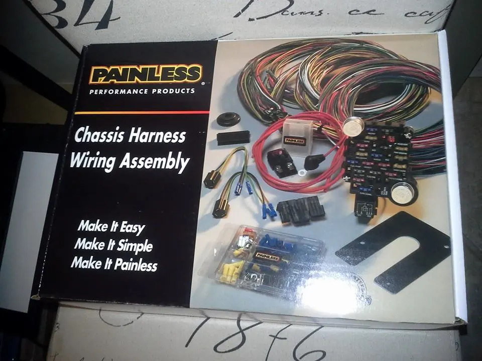

I'm going to order it from Dallas Mustang probably tonight. I'll send you guys pictures!
You could always relabel a circuit if you need to ,i think you will find they have everything covered though .Mine had traction control and a bunch of unusable circuits .Just remove the wires you do not need .Slip a test light in beside the wire not needed and bend the tab on the terminal and pull the unused wire out after you figure out what you really need .I had a box full of wires left over .
Well, here we go. I'll try and post progress pictures as we go. Wish me luck!

I used painless on mine and loved it. Each wire is stamped with a number and also says on the wire where it is coming from and where it is going to. You almost don't need the instructions. If I remember correctly most of the connectors needed were there except the wiring connection for the column wiring (blinker and horn). They did however miswire a couple connections like dimmer switch and one other thing I cant recall right off so it would be a good idea to verify. It also had extra circuits for add ons such as electric radiator fan etc.

First thing is make sure you have everything you're supposed to have from Painless. I got everything just fine, but it's important to look. Good job Painless.

To their credit, Painless uses the REALLY NICE plastic coated terminal on most of the wires. These are great! What would make them greater? Being able to reuse them after you have to cut 90% of them off because, HEY, THEY'RE NOT USED!! You see, you have to cut them off to crimp on the "factory type terminals" which, ironically, use a really special crimp tool that no one EVER NEEDS . . . except for factory crimps . . . THAT NO ONE USES THAT MUCH NORMALLY. They're happy to sell you the tool for about $100, though. To be fair, it's not their fault. That's what Ford uses.
Okay okay, so it's not that bad, and I'm having a frustrating day. On a more serious note, it WOULD probably help if they gave you some routing ideas. That IS "painfully" missing. To me that would have been an easy touch.
