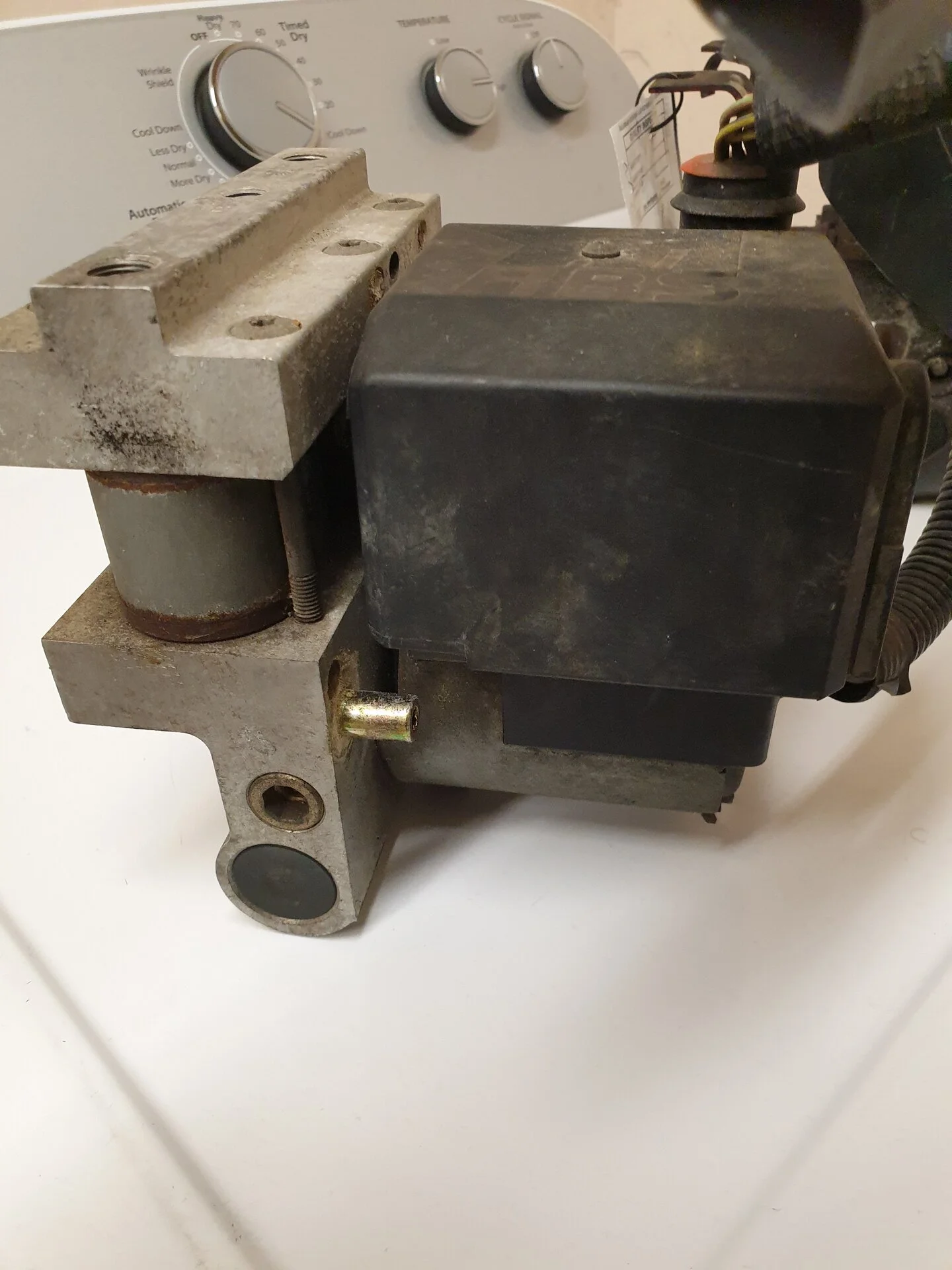

I had the same problem with my 97 Cobra. Scanners wouldn't communicate with the ABS module. I purchase a used ABS unit for $95, it worked. Finally got rid of the ABS fault. I think it was the ABS module.
