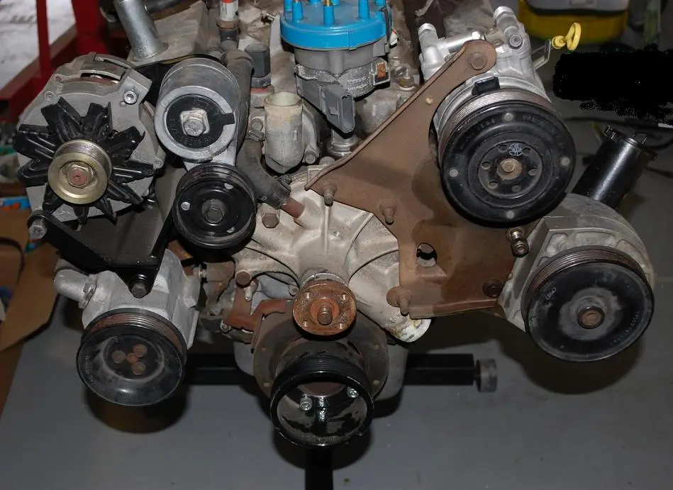

Does anyone have a good set of pics for the Accessories and Brackets?
I'm putting an 89 back together... this thing has had numerous deletes mixed with some of the OEM brackets and I'm having difficulty figuring out how this portion goes back together.
Pics of an OEM setup should get me what I need to get it going again. That large alternator baracket is giving me fits and I don't have my car here to refer to.
Thanks in advance!
Be careful, a couple of these have the A/C deleted and most have the3 smog deleted or skipped. Let me know if it helps.

Does this help?
Thanks all. I've got one bracket that 'IS' the alternator bracket but may be a bit different than the ones in the pictures. I'll have to snap a couple pics of it tomorrow. I can't find bosses in the block that appear to line up with it.
This car has manual steering, AC delete, smog delete, and the bracket that I'm talking about. It almost looks like it has spaces to mount two alternators. I would imagine that one of the spaced gaps is the for the alt and the other for the smog pump. Is there such a bracket? Does that bracket contain mount points for both the alt and smog pump?
I've been trying to match it up using the dirt patterns but so far am having no luck with this piece. I'm beginning to wonder if it's the right bracket for the car.
