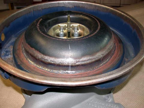

i don't know why anyone hasn't considered modifying the air cleaner especially on the aftermarket units, just cut the center of the air cleaner out and add some material to make the base sit lower over the carb and you can basically set it to wahtever height you need. i can see not modifying an original shaker base since they cost so damn much now, but i see no reason why you can't modify a repro unit.
edit: here is a pic i found that a guy modified the air cleaner base for his 429cj 71 mach so that he was able to use a taller intake

Sicarius428 said:
Get on of those k&n extreme things which has a filter element on the top too.
Kevin
I've thought about that.... I imagine (although I haven't tried it) that the top isn't strong enough to hold the base on the engine. The air lid is the primary thing that holds the shaker, base, etc to the engine.
d
d
I used a K&N "X-stream" filter top on the ram-air air cleaner on my 73 Mustang. It is plenty strong enough to hold the air cleaner in place.
