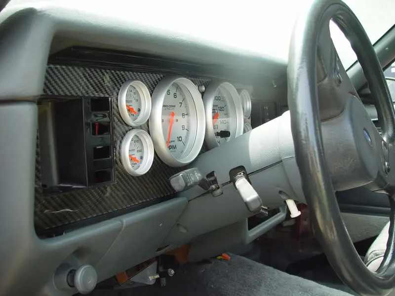

If it's a mechanical speedo it will work The Autometer speedo is threaded unlike the Ford speedo, but you can press the cable on there and it will stay. The shaft on the end of the cable fits the Autometer speedo. I used the front piece as well, here's a pic of it in the car:
