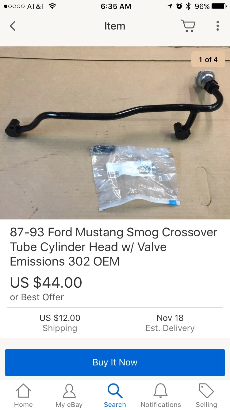

Or can they be bought new?
As close to new as you'll prob find
