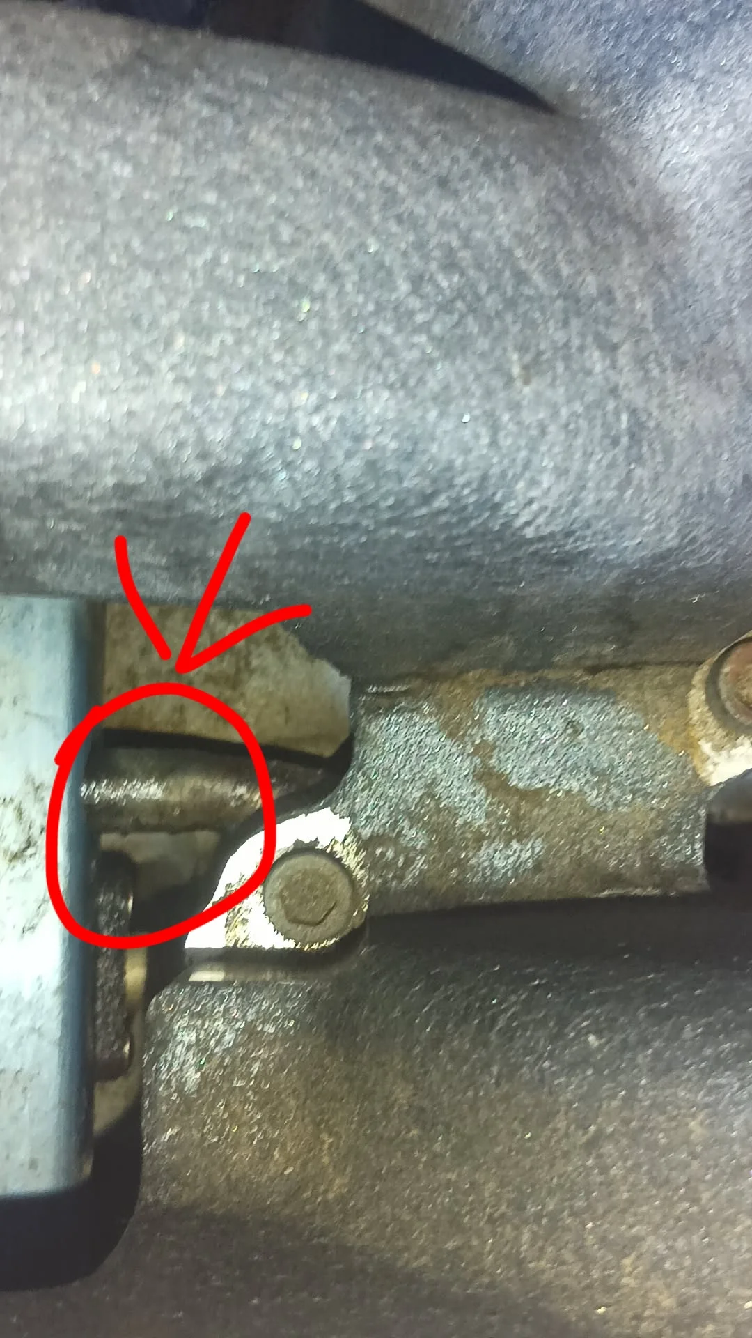

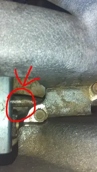

Hello everyone I have a 94 Mustang GT with a BBK SSI intake manifold and I believe the crossover tube on the fuel rails that came with the intake is starting to hiss and leak,
My question is how exactly do you replace it it seems to be held into the fuel rails it self which is kinda fishy if you ask me as a design but how do you remove it and reinstall it, I've looked on BBKs website and I'm not getting much results, there's absolutely no videos on it and I've heard it's discontinued as well
I want to switch to a trickflow soon but I just want this intake to work on this beach trip coming on the 30th of May any help would be appreciated
Its a good read if you have some time.
It looks to me like that intake is going to need to come off and be repaired at a machine shop.
In the image, it looks like a break in the cast.
