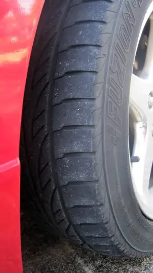

Front Passenger

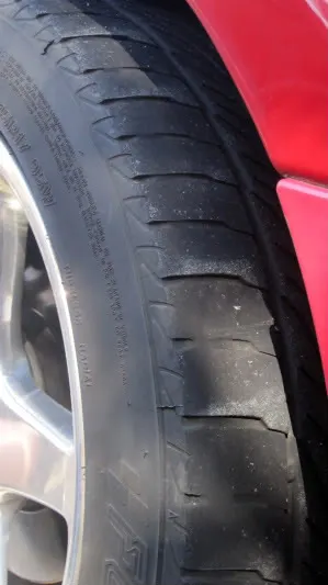

Front Driver

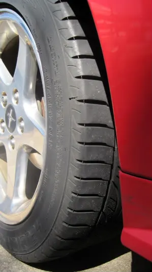

Rear Passenger

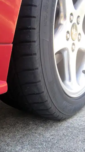

Rear Driver
So how about putting the rears on the front and getting 2 new tires for the rear? Still have not done taxes and am not in the best of financial situations.
The tires starting to cup. Like the previous poster said that is more likely caused by lack of rotation. your alignment could possibly be adding to it some what. Just go to a local Les Schwab if you are on the west coast. They will do an alignment check for free. Trust me I work at one doing alignments all day:D

I fully understand the possible wear from lack of rotation, however, why just the one side? Possibly cause it may be just a hair off?? I just wish I had a garage to do some of this stuff in.
I would definitely take a look at the alignment.Judging all four tires,the fronts are obviously cupping,but the passenger side is a lot worse while the driver side is minor.Rotating will help,but for only some much,cause if the alignment is out,it will keep happenning,and tires get pretty expenssive after awhile.I myself have been running wider tires out back for a while now,so rotating can't be done,and i never had a cupping issue with my front tires ever since i bought her new in '03.A good alignment,will either slow this down (depending on driving manners),or make it non existent in my opinion.When i still had the original Good Years,i got 5 years out of the fronts without rotating them.What killed was dry rotting/age LOL!Other then that,the wear on the was perfect.
