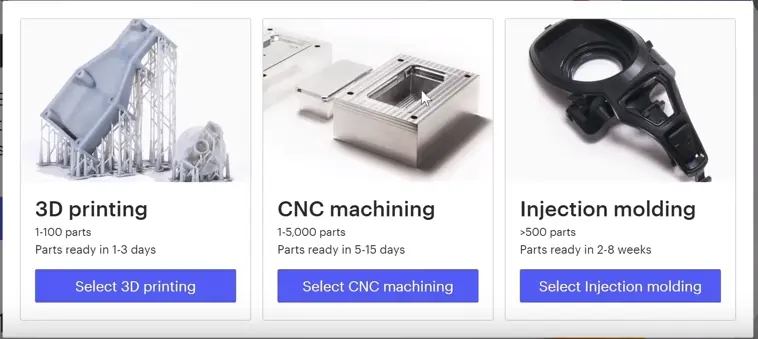

How cool would it be to get stuff printed, injection molded, or CNC, [exactly] how you designed it without having to own the hardware?

Watch this entire video. I know there's a ton of guys in here that can use a service like this. What's awesome is that it's open source! The "printers" belong to hobbyists like us.

That's pretty freakin cool Noobz...coulda made the air box outta plastic....may look into it.
It still looks to be a pricy process nonetheless. If it cost about 15 bucks to get those two basic small pieces made and shipped in US dollars, I can only imagine how much it would cost to have something large and complex like the air box printed.
I'd still like to mess with it though...I'm gonna set up an account.:nice:
