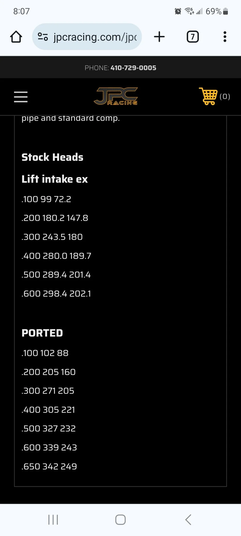

Coyote cylinder heads will out flow all SBF inline valve heads stock.

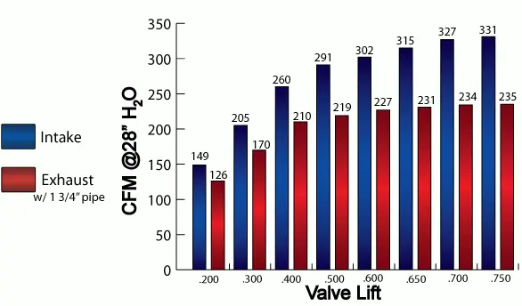

I guess the Renegade version of the AFR flows even more:
I'll grant the low-end of lift shows significant outperformance. On the high end, not so much. In any case, is this what we care about? The Coyote has 20% less displacement to make up for, and there's no reason an NA Dart build has to give 20% peak RPM.
