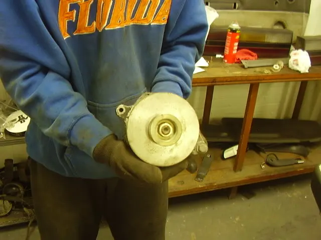

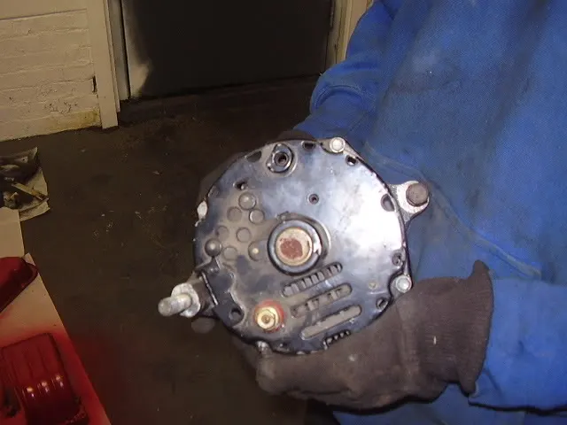

2. the previous owner installed a one wire alternator ( i think pic included ) they ran a wire from the post on the back of the alt. to the positive battery terminal , this looked liek crap and unsafe , I plan on running the wire from the post to the positive side of the solenoid with a fusable link in place ( close to the alt right? )
The previous owner also cut the factory alternator wires and capped them with wire nuts
is the best way to clean this up to just rewire the factory plug and hide it in with harness ?
