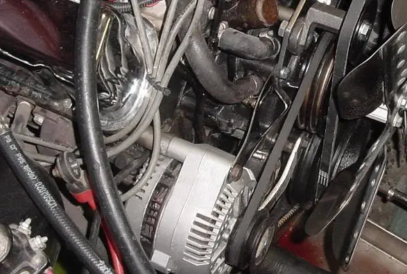

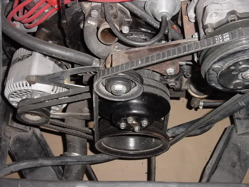

so i got the power steering pump figured out tahnk god haha and now im on the alternator problem do you happen to know where i can get a picture of what its supposed to look like or a diagram because i know its increadibly simple and i have even taken it on and off a few times before but for some reason today is not my day and i can not figure it out haha sad but true thank you again
Maybe this'll help?
ok that kinda helps deminstrate my point, if i had that setup i could easily do it but i have a diffrent bracket in my car, i will have to try and take a picture of it this afternoon, i know im bad at getting pictures on here, but its a little more strange but thank you so much for hte pictures, i will try and get mine on here so maybe someone can help me out
