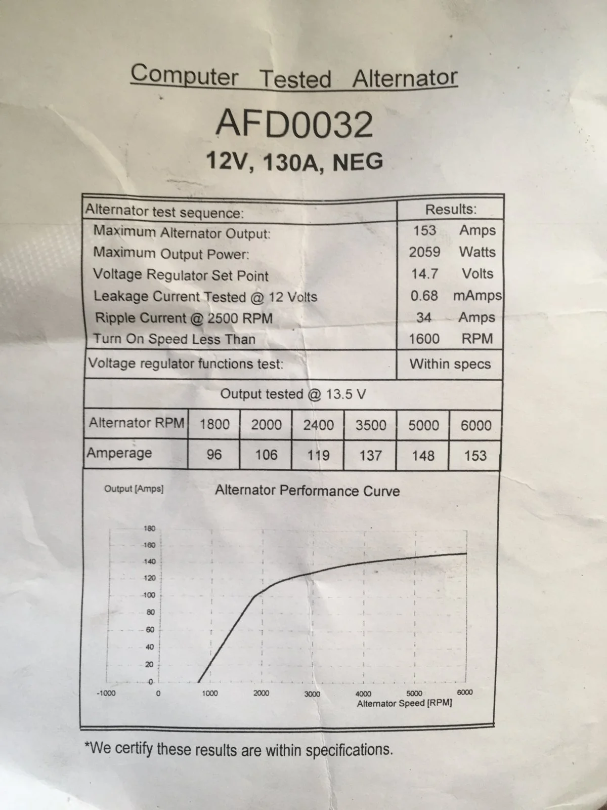

The alternator is a DB Electrical unit. Got it on Amazon for $78. We’ll see how it holds up. It came with a spec sheet.
https://www.dbelectrical.com/alternators/automotive/ford/mustang/5-0-liter/

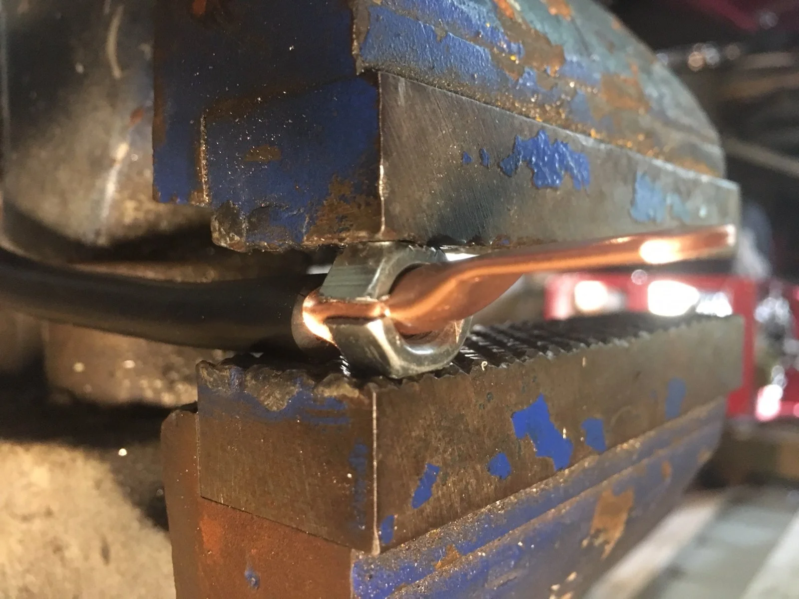

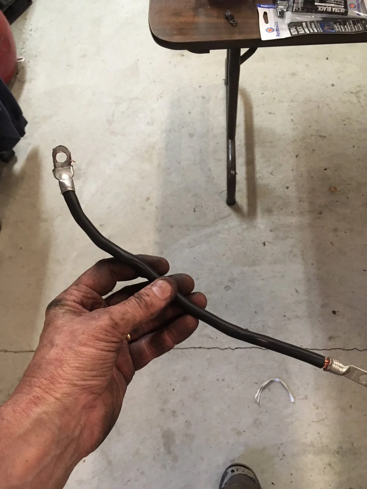

I've got it wrapped up I think. Made the cable and trimmed other wiring. Enclosed everything in conduit, taped ends, zip ties. The usual backyard tactics. Its reliable but not gonna win any show car trophy. I wasn't trying anyway. Anyway, pics are everything so here's a few with captions.

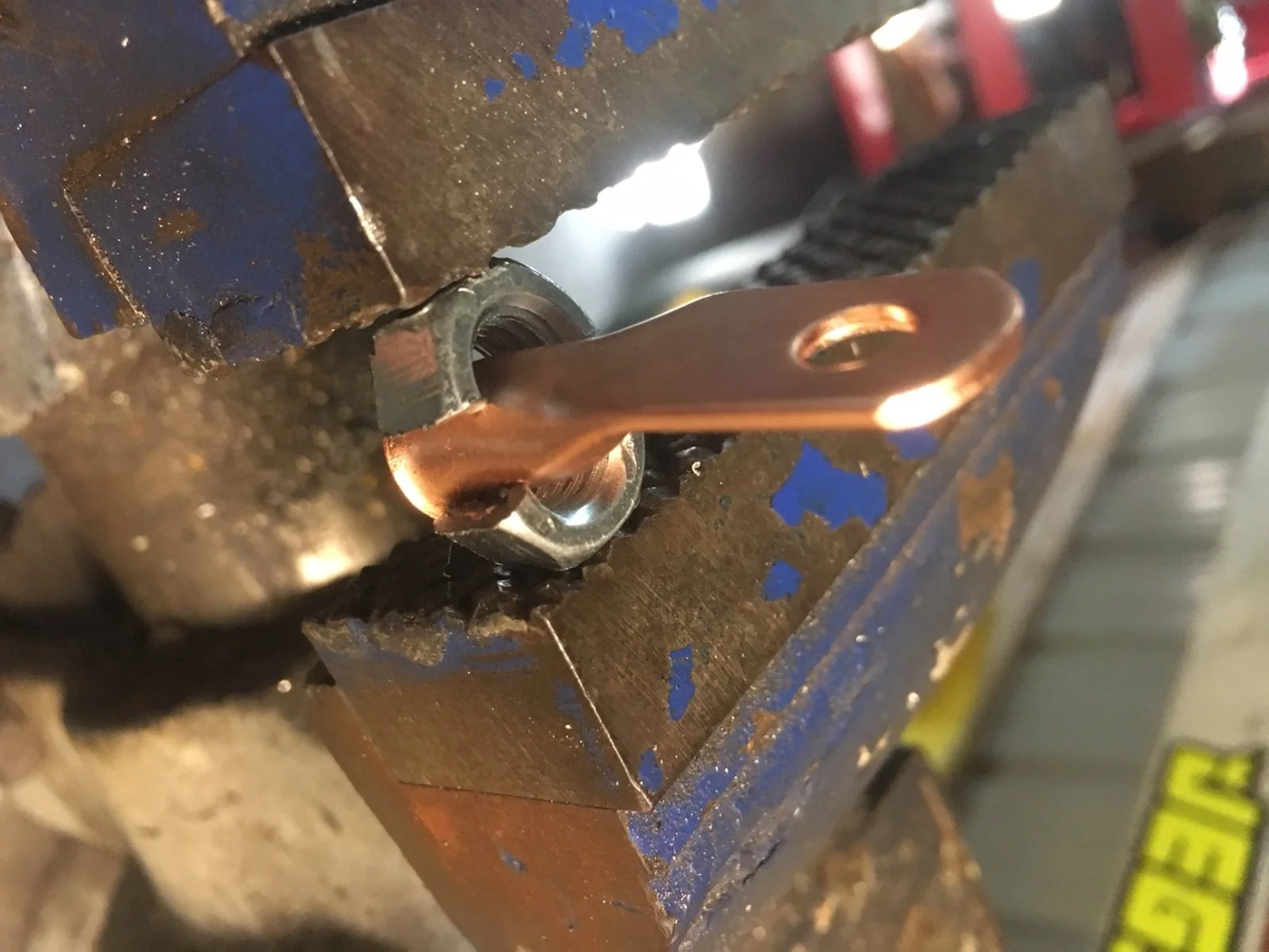

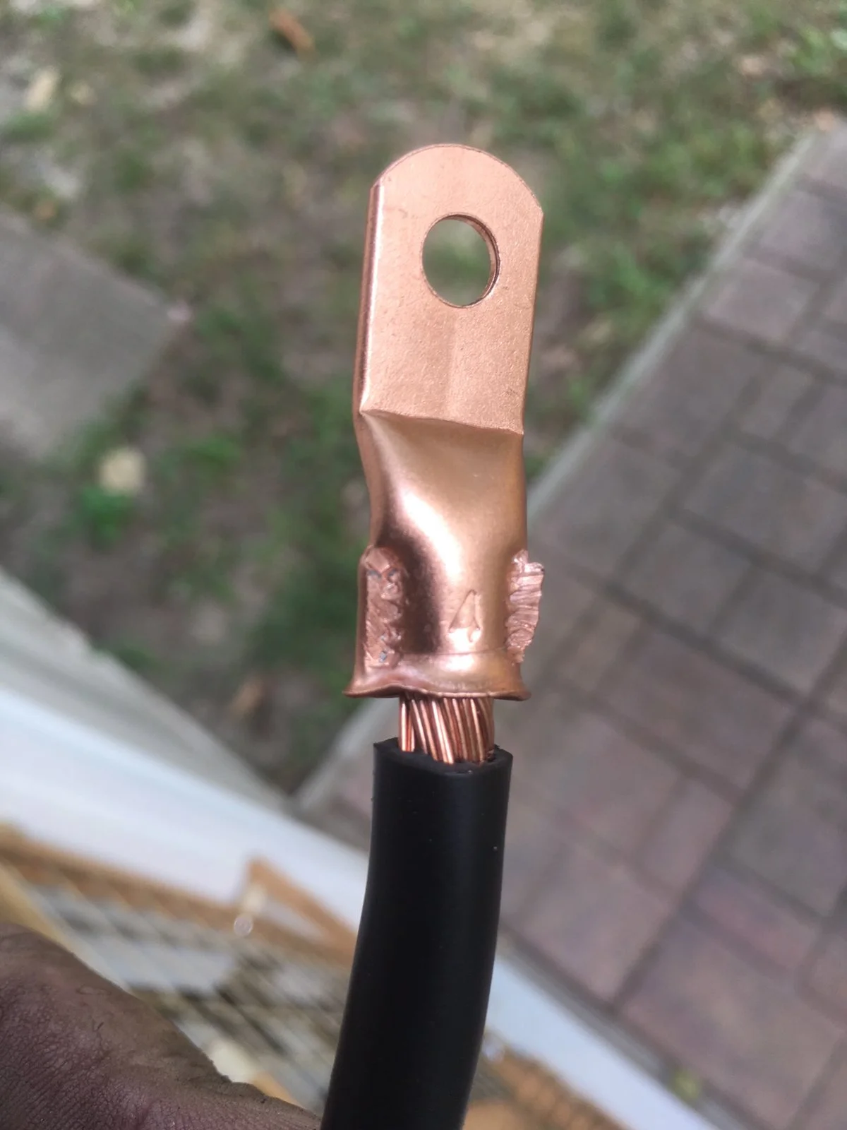

Saw this done on YouTube. Made a crimper by cutting a nut in half....here it is
Put the cable in and clamp down with vice

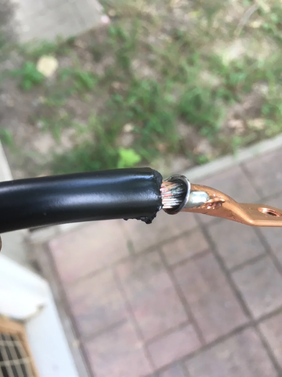

Heres the result. Pretty good huh?
Sweated some solder in for good measure. It sucked up a good amount

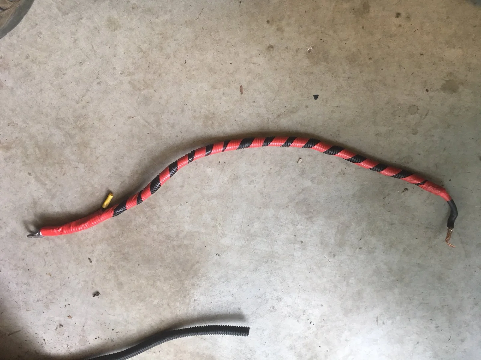

Here's the finished cable wrapped in conduit and marked with red electrical tape.

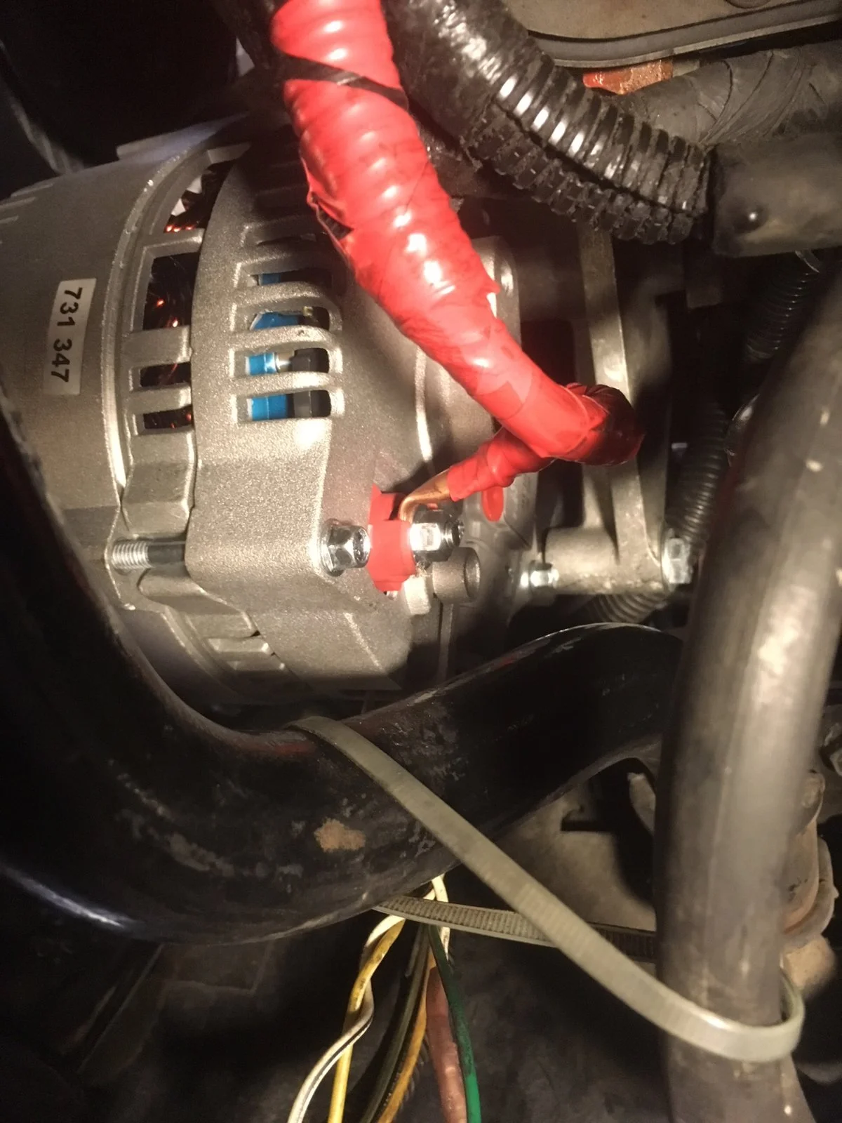

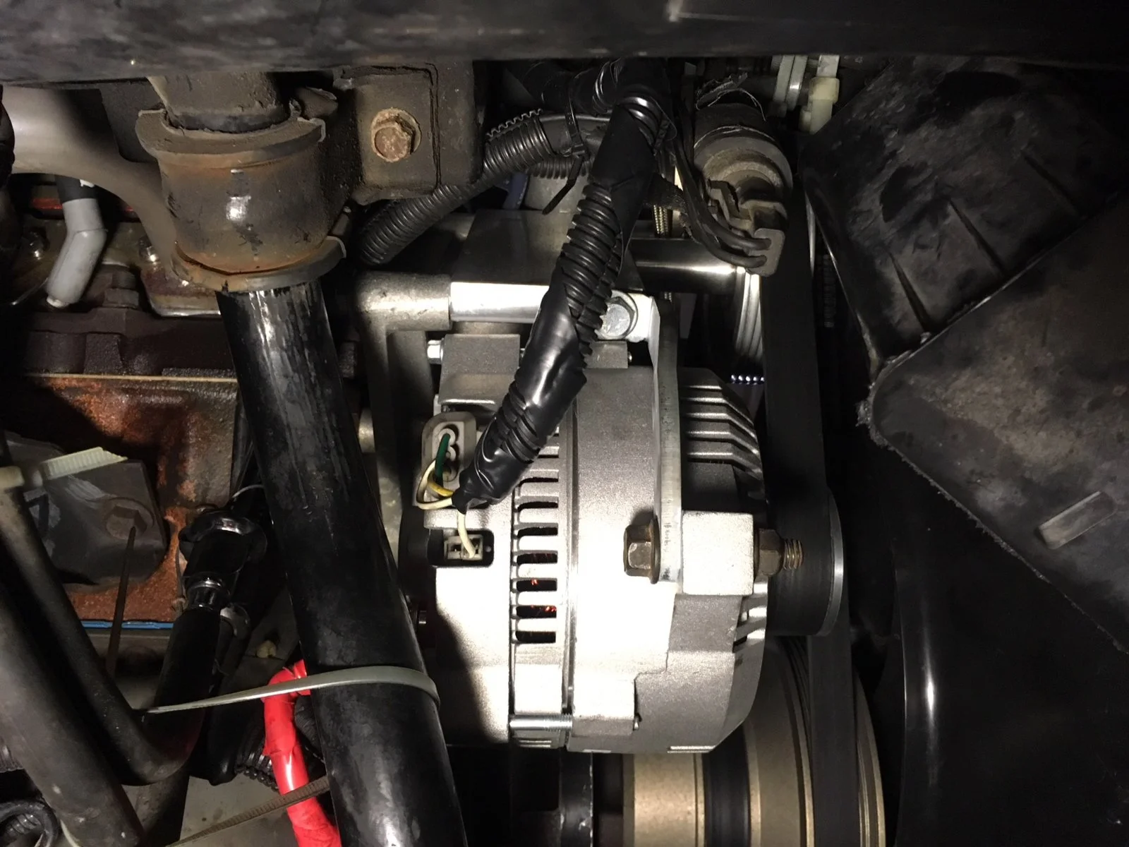

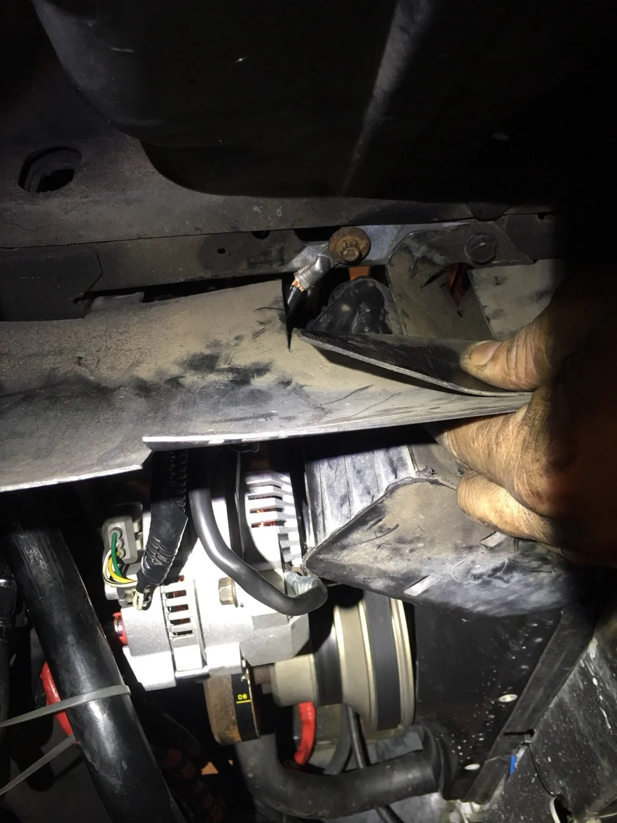

Continued from above. There's a third post with more pics too

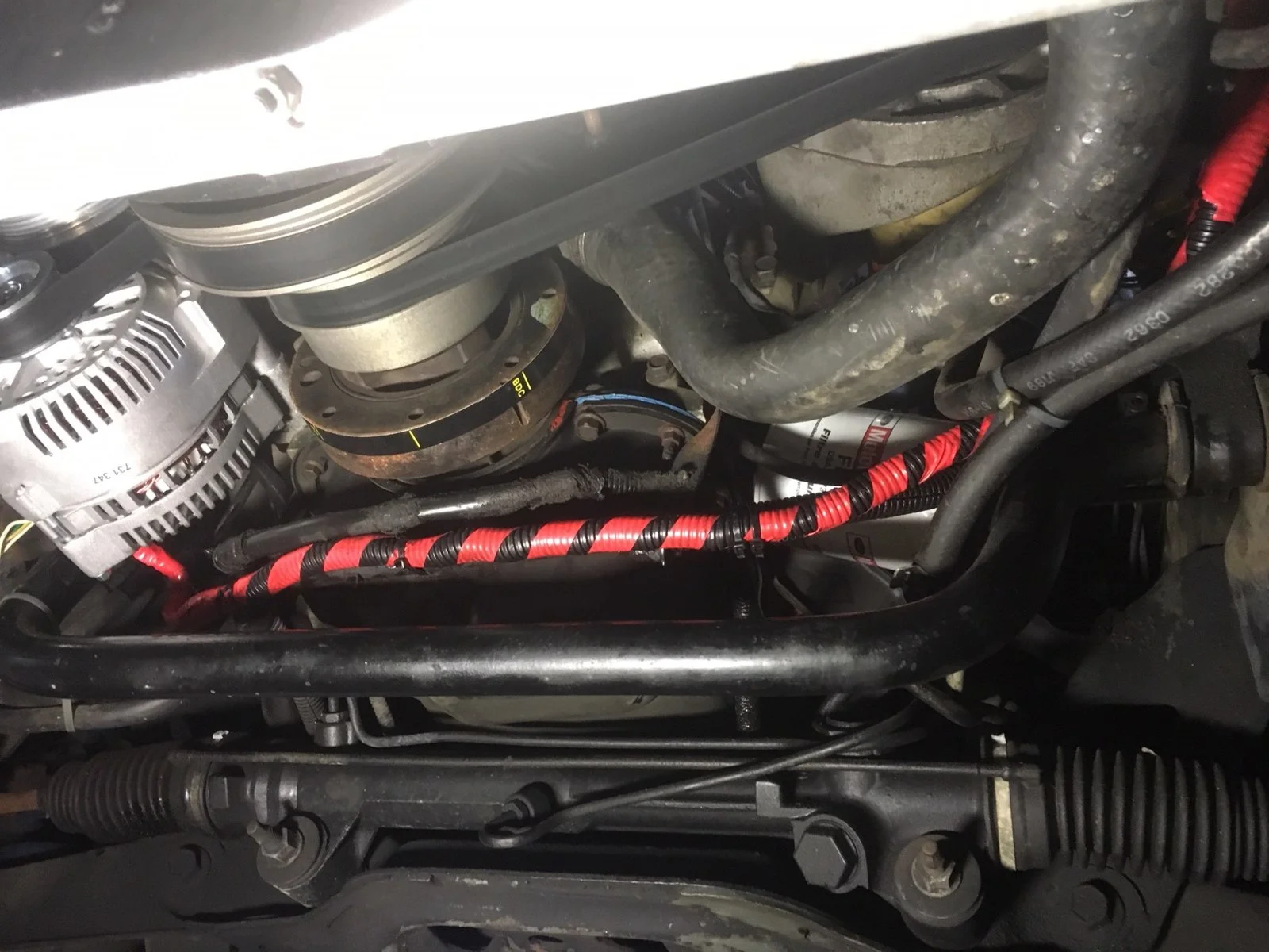

Here's the cable installed. Its secured to other conduit that runs under the front of the oil pan.
Here's the connection at the alternator

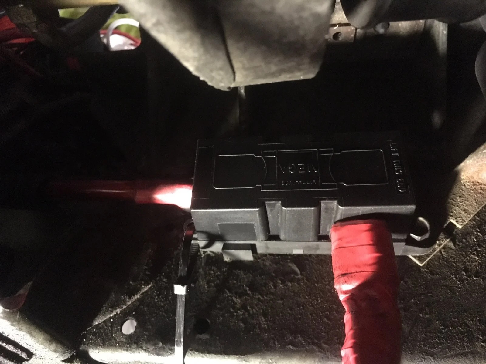

Here's the connections at the fuse holder (125 amp fuse) located on frame near power steering pump.

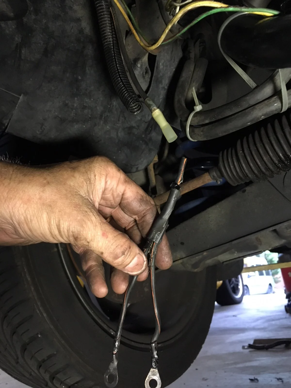

The original double #10 wires were cut off to reduce excess bundling. I'll keep this section in case its needed in future. The remaining single #10 was capped with a shrink wrap connector so it's available for future use if needed.
Here's the regulator and field wiring wrapped up in conduit.

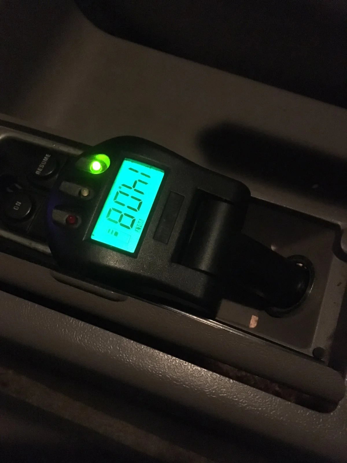

Made another ground cable
Connected ground cable from alternator bracket to passenger side frame
AC gets really cold on medium fan setting. Holds good voltage at idle with AC on, Burrrrrr.......
I love this cig lighter voltage reader. I have several of them and order more to give to friends, I highly recommend you get one. It gives real time running numbers. It's amazing how much movement you get from factory gauges on the foxbody mustangs. I can see how people think they have a problem when looking at the factory gauges. In reality, they are accurate but difficult to get comfortable with. The factory gauges fluctuate substantially, still be in the normal range and give you no clue where you actually are. That goes for voltage, water temp and oil pressure.
