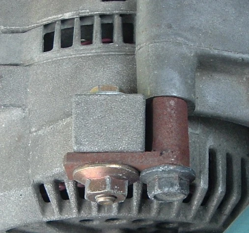

Pic attached!
I had this problem with Fox covers and I just made up a spacer that rotated the alternator top toward the passenger fender. Just a little standoff that's the same height as the alternator top pivot and about 3/4" diameter with a flat steel bracket on the face that acts as the mounting point. I'll try to take a pic tonight and post it when I get home, but it's pretty simple.

I needed just a tiny bit more room with my Fox vc's.
I did not want to grind down my alt electrical bolt or grind on my vc's.
I dug around in my spare can of bolts, washers, nuts, etc until I found three washers of the same size (80 thousands thick) and moved the alt away from the vc.
Been like that for over three years now.
