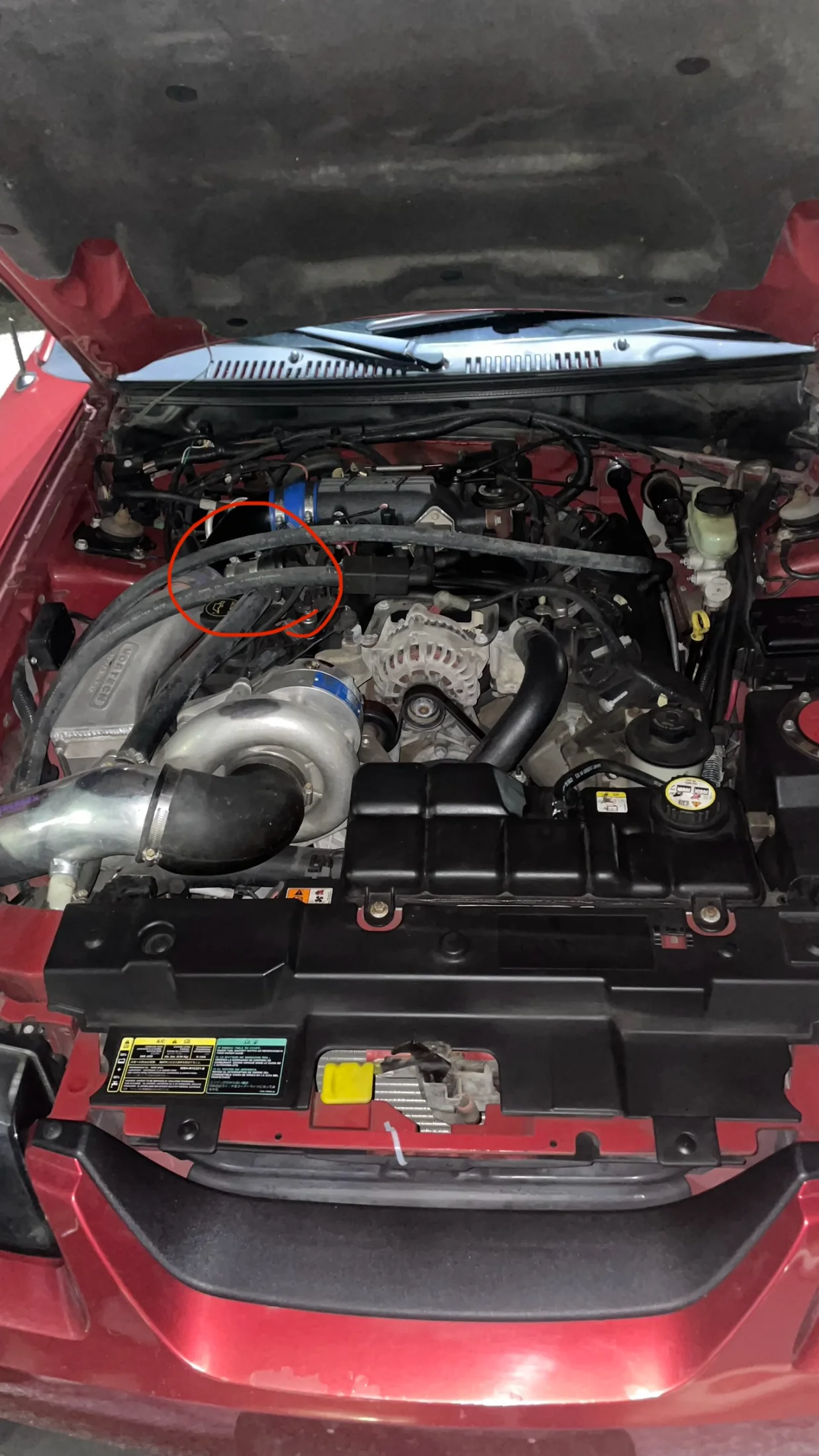

I have a 2003 Mustang GT with a Vortech v3 Si Air to Water power cooler on it, it seems to be the anderson kit judging based off of the power pipe if that matters. I have been looking into upgrading the blowoff/bypass valve but every single upgraded BOV seems to have a mounting flange/bracket, in my particular scenario the "Vortech standard Bypass Valve" is mounted on a 25mm barb on the charge pipe which also connects to what seems to be another by pass valve right before the power cooler by vacuum line. How would i upgrade to something like the vortech maxflow bov? Or what alternatives are there out there so that i can upgrade my "Vortech standard Bypass Valve" to something with a little bit more sound?
Attached below is the current best photo of my BOV if anyone needs the visualization.
