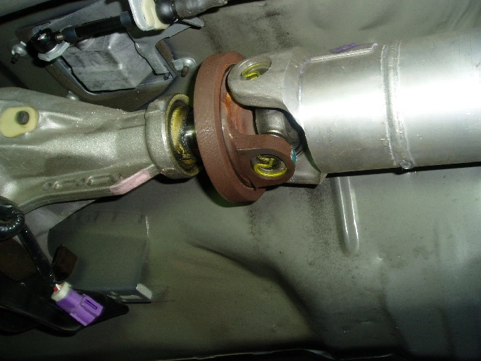

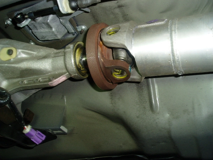

Typically aluminum driveshafts are only offered for manual. They will work on automatics with only very slight modifications. Your shop will do these no worries :nice:
the new drive shafts come balanced. so if you switch out the new yoke and put on your old yoke on the new shaft, it might be a good idea to get it re-balanced.
...or maybe it's not neccessary, i'm not sure. but that's something to think about
fastangboi said:
What kind of modifications for the auto.
Just swap out the yoke. More Pics Here
