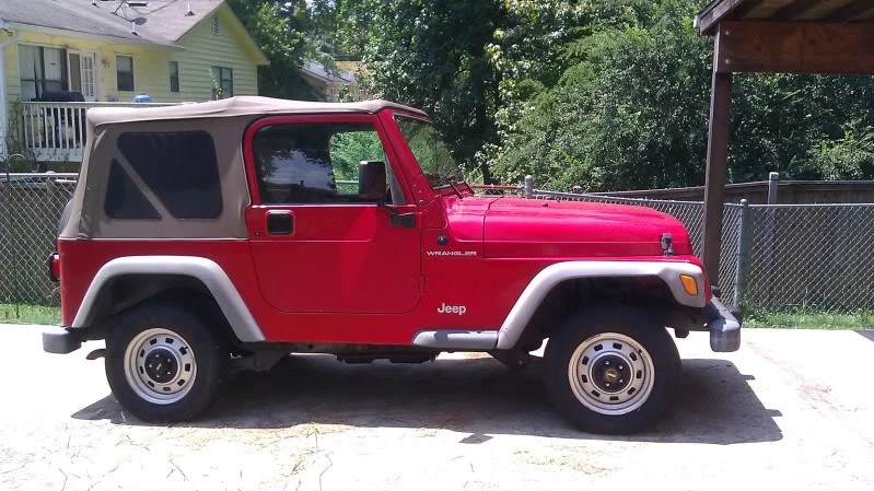

Anyone here into Jeeps?
I just spent the day sweating my testes red trailering a friends Jeep from downtown to my house in the sticks. First of all, I would like to start by complaining about Uhaul's astronomical price hike on car haulers from $29.99/day to $55.xx/day. My friend is leaving the country in a few weeks, and wants to get rid of this Jeep, and I offered to sell it for him. It recently developed a nasty overheating problem, which is why I had to trailer it here. It overheats after about 5 minutes. Hopefully it's just a busted thermostat and nothing more sinister. Needs a few more touch up things, like some trim pieces, and getting the AC to work. It's a 2000 Jeep Wrangler 4cyl, automatic.....ah, red. I know, not exactly the most desirable Jeep ever made. I'm still surprised how much value these TJs retain.

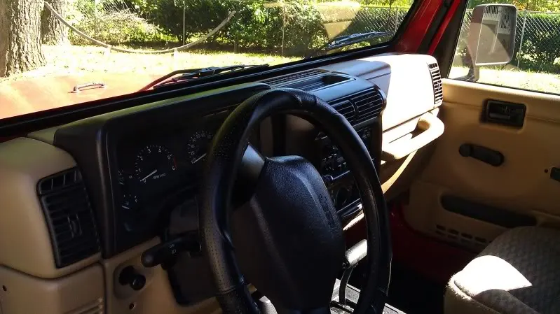

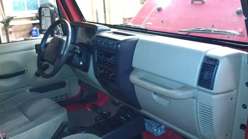

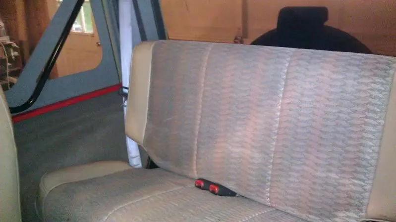

The wife and I spent 4 hours on Tuesday cleaning the filthy interior. I took it for a long test drive yesterday, and it seems to be running tip top. Just need to give it a wash and a wax, and it's ready to go on sale. I've never owned a rag top, nor have any desire to. What is the best cleaner to use on the plastic windows?
