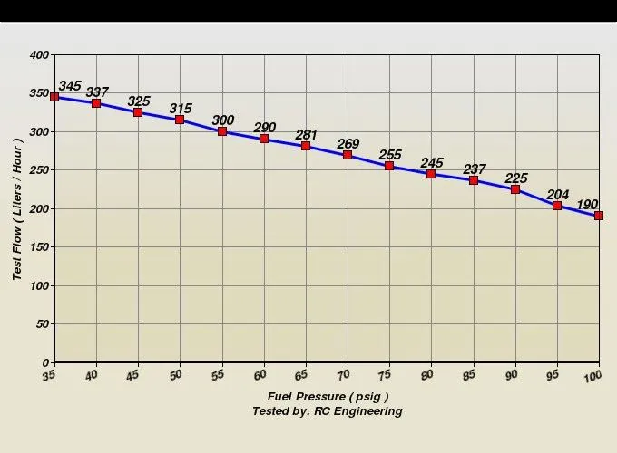

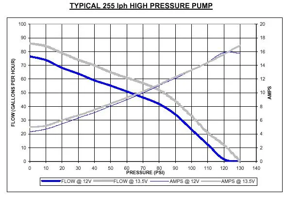

The 340 doesn't seem any different from the Walbro 255H.
http://www.autoperformanceengineering.com/html/fpspecs.html
You don't need larger fuel rails or lines for a 10lb blower. I have a 13 lb blower, which had 19lb injectors & a 12:1 FMU, now 30lb & 6:1. I also have an intercooler which helps a lot.
The C&L requires a minimum of 6" of straight pipe in front of it, or you will flow turbulence. I have been fighting this issue & have redesigned the inlet to provide 10-12", while still providing the proper size & location for a BOV. Mine is blow-thru, not draw thru.
You can compare the 2 graphs, but will have to convert lph to gph or vice versa. 4 lit = approx 1 gal
The upper end of the graphs are what you are concerned with, at 100 psi, both flow about the same.
