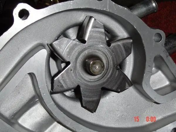

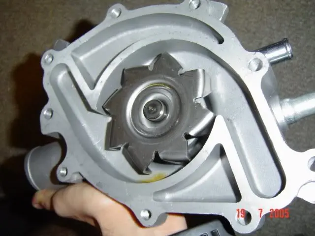

You can get a WP for a 88-91 Crown Vic, but I think you'll need to clearance the pulley holes so they match up on the pump.
I found these on the internet; heres a look at the impellers and the cavities. The reverse impeller does look more efficient though.
Reverse
Standard

common mod when doing belt routing changes. 88-91 crown vic water pump will bolt right up. you will have to modify the pulley bolt pattern by drilling new holes or elongating the existing holes if you want to use the serpintine pulley. I think and truly believe the other stuff is a myth about the coolant flow, The only thing that would make sense if things warmed up after is the fan blade angle. most people doing this mod run electric fans but if you notice the pitch of the fan blade is set up to spin a certain direction, once you change the rotation you change how it draws in air. Look at the old metal fans on the standard rotation water pump stangs and pitch, size of the blades they are different, this would be the only thing I could think of that would different. The coolant flow path would be the same.
