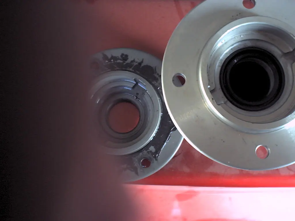

Pictures to help explain. please help
this first one shows how much farther into the bellhousing the new one will go.
It also shows, that the new one will go into the tranny further.
Not a good pic I know, but trust me it measures longer by a bit.

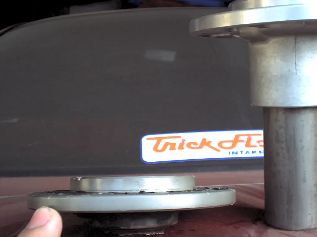

the third one, shows how the depth is different. which I understand is why you would need shims. but for example let's say the new one calls for two shims cuz its deeper, but at the same time its two shims worth longer.
Man I am confused.
one other quick question, on the side that goes into the bellhousing. see how the plate has like a nipple that covers the shaft a lot further. will the throwout bearing hit that before the clutch is fully engaged, will it slide over it somehow.
this is getting to be quite an ordeal.
help me out if you can please.
