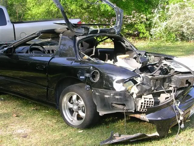

Id like to hear the story behind the Trans Am

Any story on the TA?

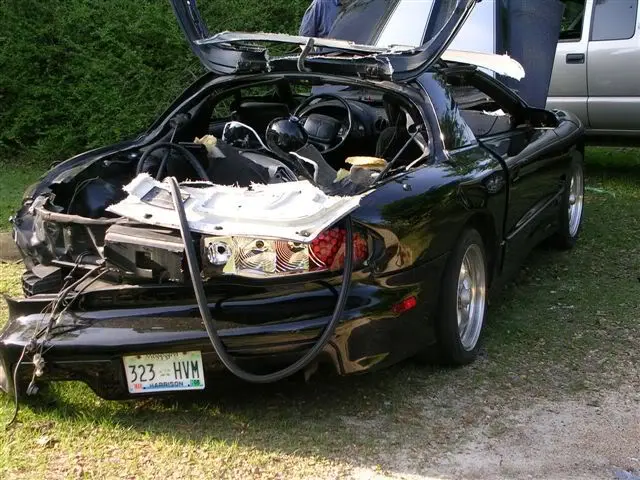

its one of those storys that got passed around the internet... dunno if it had a blow down on it or if it had any blow off disk on it. but it was left in the back hatch under the glass in the middle of the summer and KABOOM. atleast thats how i heard it
i know that the best way to mount the bottle in a TA puts it right up in the rear window, so i could see it getting cooked pretty fast.

I dont believe for one second that that damage was caused by a exploding bottle,. Ive never seen a bottle without the high pressure release(set at like 1500psi I think)

What I mean is that it does not appear that car was hit, something obviously wanted out.
i buy it-look in the 1st pic the left rear quarter is bulged out, then look under the bumper skin, the actual impact material (grate like stuff) is unhurt. that would have been interesting trying to explain to insurance. :(

You might want to rethink then, I've seen pictures of the bottle shrapnel. I spent 10 min. trying to find the article, but no success.
