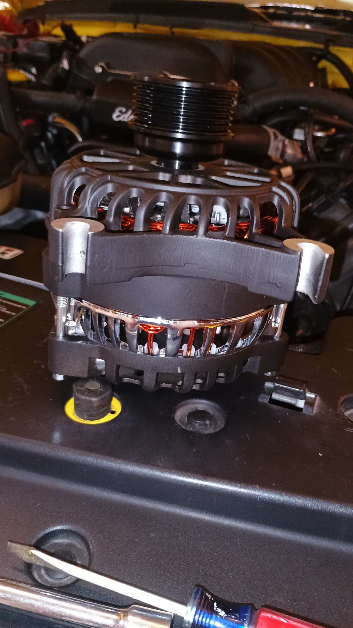

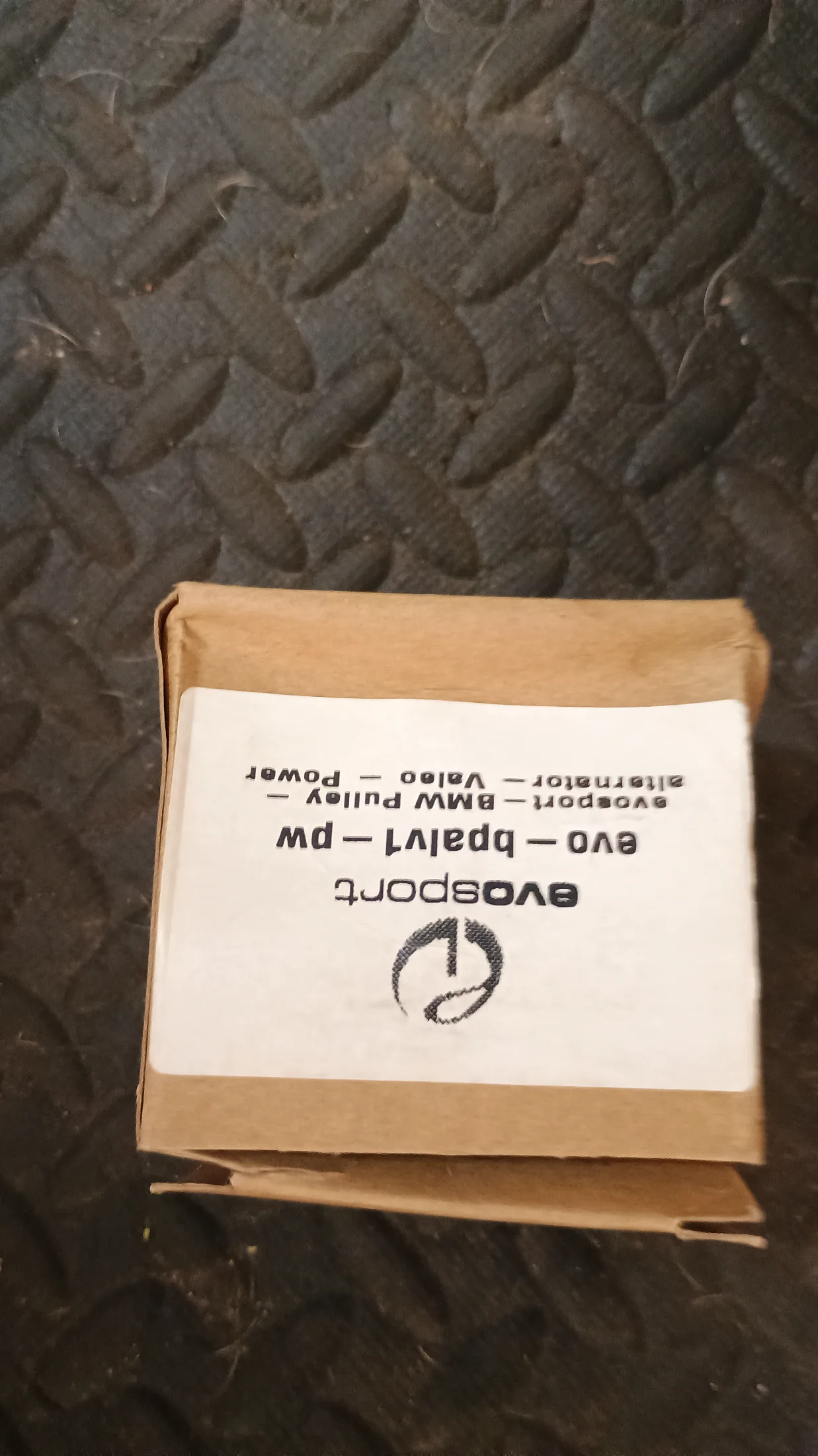

If any one is looking for a replacement alternator pulley for a Edelbrock E-Force supercharger kit 2005-2009 Mustang GT you can use a under drive pulley from a BMW M3 it's a direct fit extended shoulder 6 groove pulley use red locktite a lock washer and impact the nut on.
